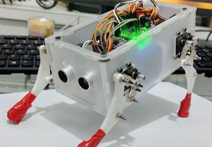

Project Description
When I first saw this dog, I wanted to name it a moving repair dog~, so the name of the project was a moving repair dog;
Production idea: I am more interested in servo control and 3D design;
Implemented functions: The basic functions of the dog, such as installation, stepping, forward, backward, etc., have been realized. I originally wanted to implement ultrasonic ranging and avoid obstacles, but the module was broken. The power indicator module and a servo failed before video recording, so the effect was a bit strange.

Servo: MG90S metal gear
Main control: Chuanzhi Hi3861 module
Battery: Two parallel and two series 18650 lithium batteries 7.4V 4000mAh
Power display: 4-segment display
3D shell
The top and bottom covers have been widened, the side covers have been heightened, the thighs have been lengthened and the calves have been modified. The front and rear baffles have also been modified. The front baffle does not match the actual ultrasonic size, and the power display module does not match the rear one. Bezel matches.
