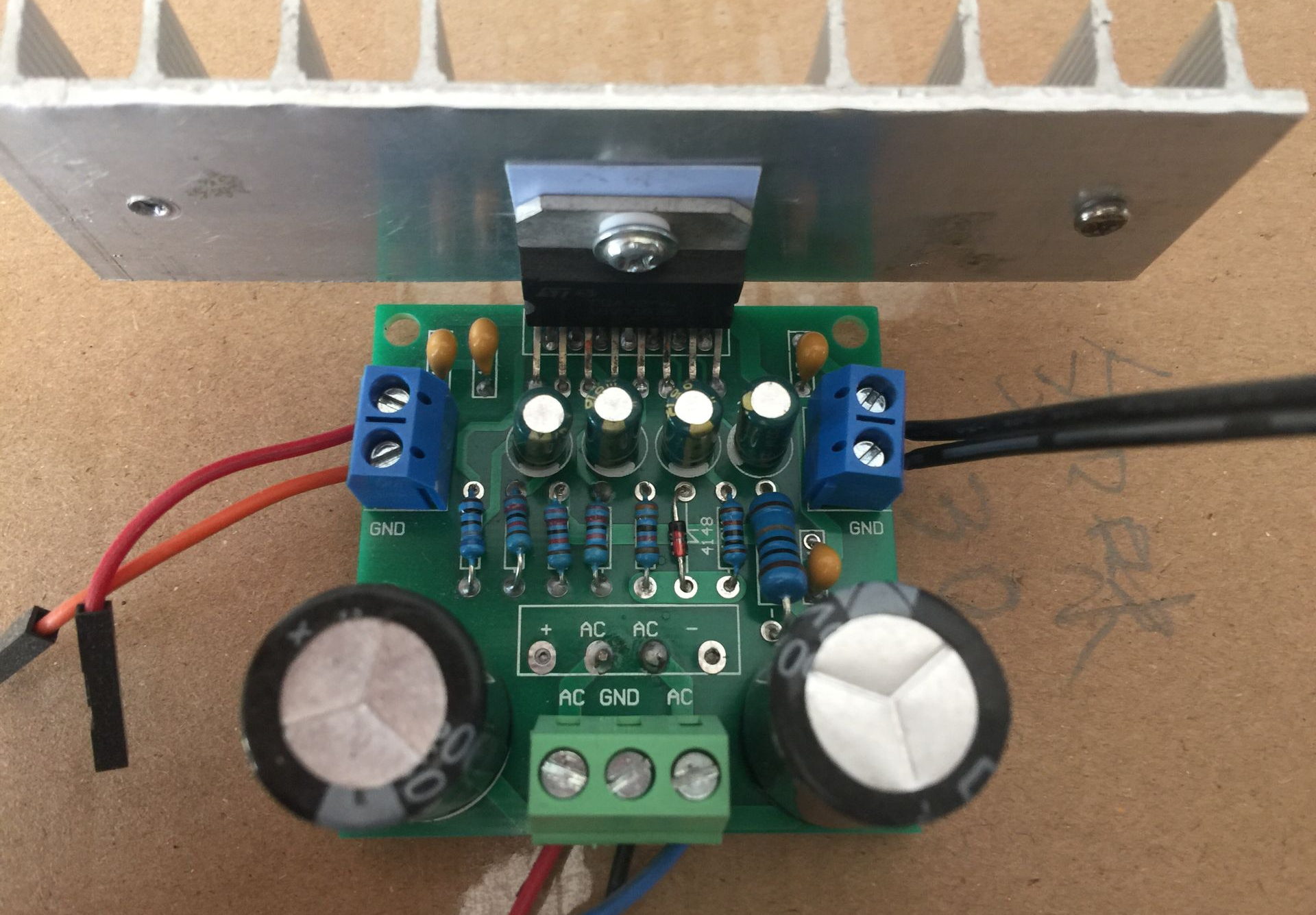

TDA7294 93 power amplifier board
TDA7293/94 power amplifier board
It has been verified, please feel free to use it! ! !
main feature:
Wide power supply voltage range: ±12V ~±35V
High output power: 100W
Standby and silent functions
Noiseless ON/OFF switch
Low noise and low distortion
Short circuit protection and overheating protection
Both TDA7293 and TDA7294 can use this power amplifier board
The bass is thick, the midrange is layered, and the treble is crisp
suggestion:
Use a speaker of around 60W
Use 4 ohm speakers when the power supply is below 18V
Use 6 ohm speakers when powered by 18V~26V
Use 8 ohm speakers when powering 26V~35V
Transformer above 100W
Precautions:
Be sure to use dual power supplies, otherwise the chip will be damaged!
Do not overload, short circuit, or exceed rated voltage!
