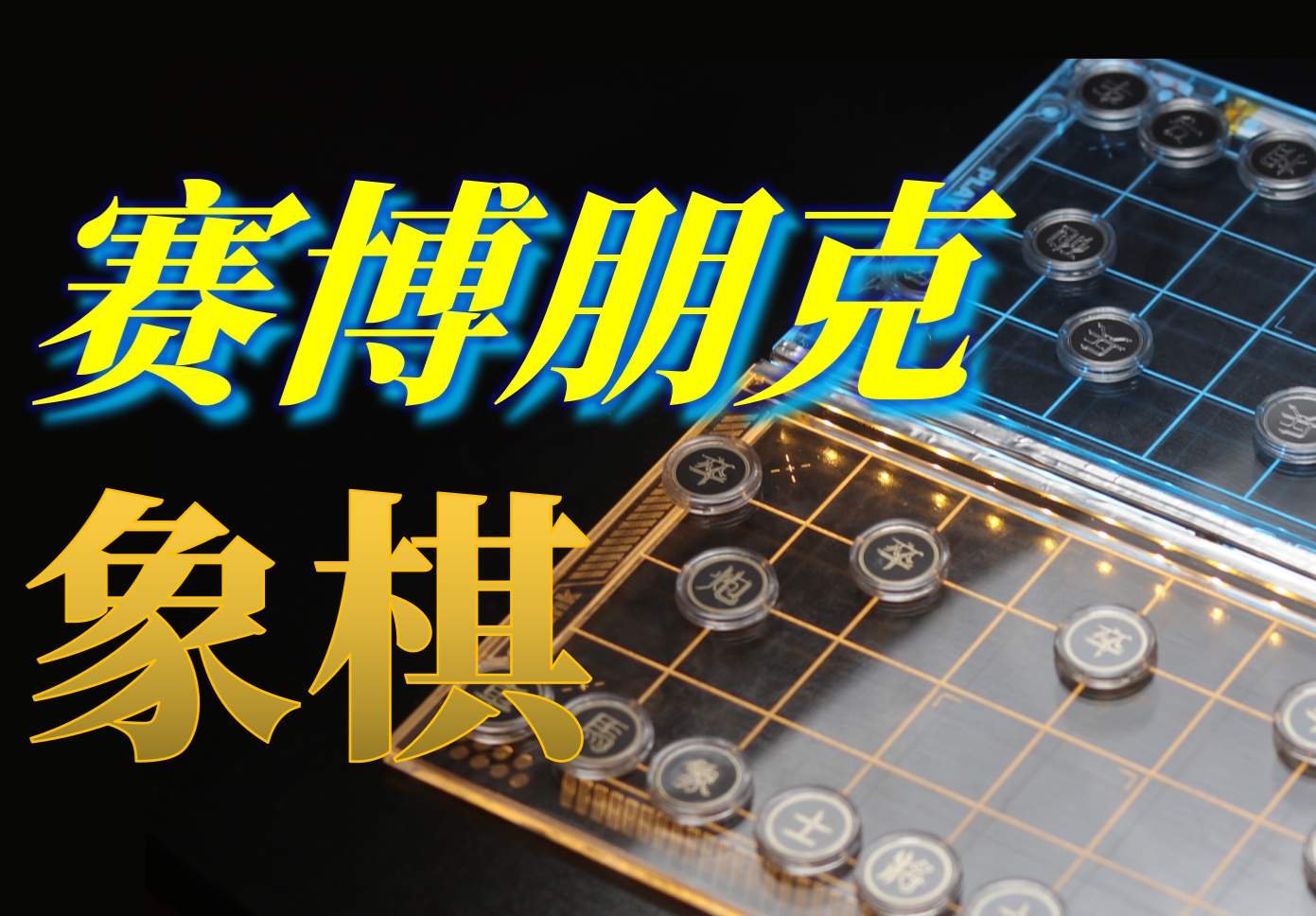

PCB chess
Making video
chess pieces
1. The chess pieces need to be cut by yourself. You can use line spacing or a milling machine to cut them. Pay attention to protecting the fiberglass dust during operation.
2. If it needs to be cut directly by the factory, you can modify the file yourself to add slots.
3. There are a total of 32 chess pieces divided into two 10*10cm PCBs, which can be purchased for free.
4. When proofing, pay attention to choosing different plating or ink for the two PCBs to distinguish the two sides.
5. The chess piece shell uses [20.5mm lotus 50-cent coin storage box]
chessboard
1. The chessboard is cut from acrylic, and the drawing is attached
2. Accessories: lithium battery (4515143), 5V light strip, 2.5mm wide, touch-type LED desk lamp adjustment Optical module
3. Use enameled wires to connect all circuits, and the enameled wires can be hidden in the middle frame.
4. The holes in the middle frame can be pasted with magnets to fix the chessboard when it is closed.
