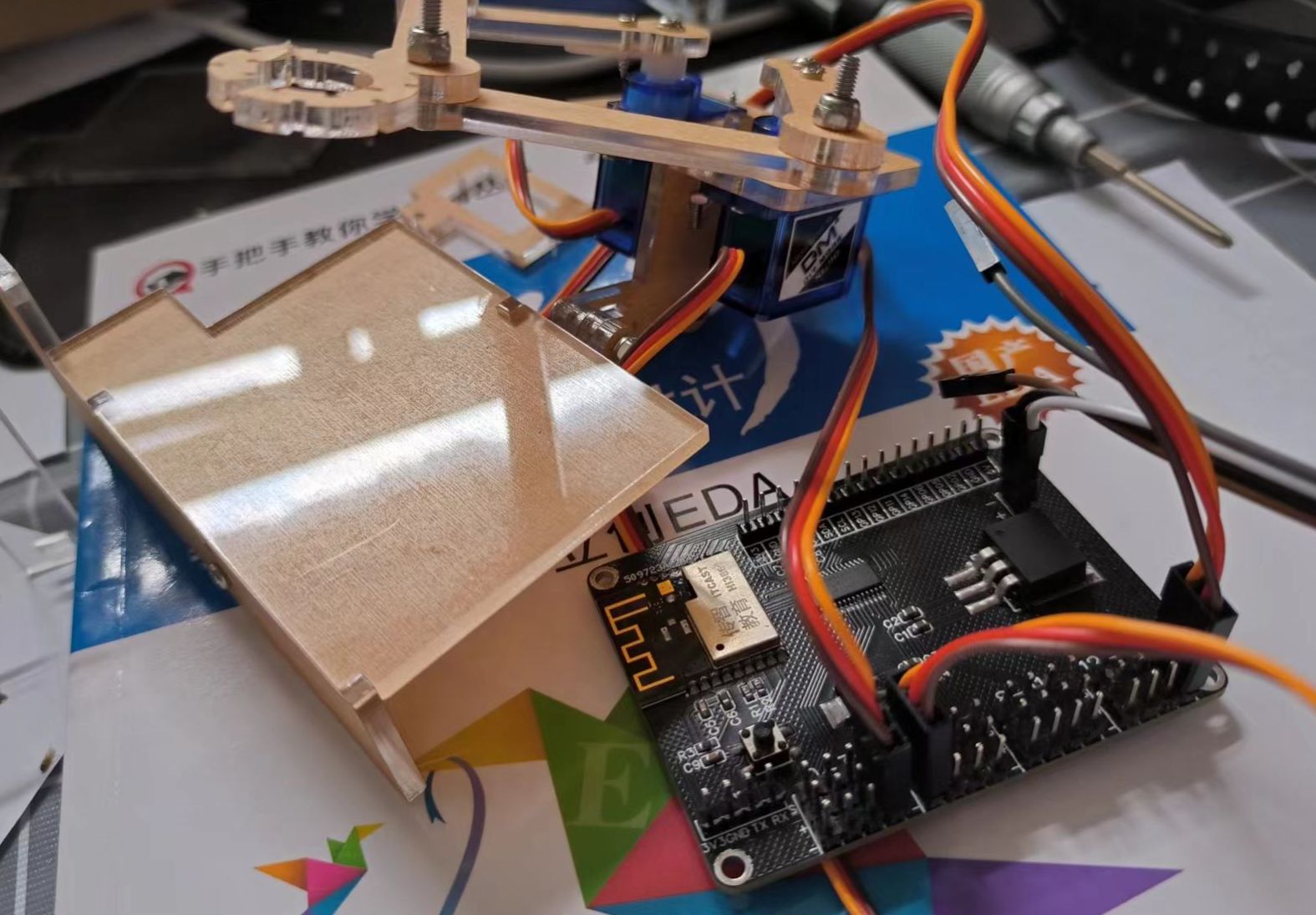

The small clock does not need to be moved. In order to save costs, it is powered by an adjustable power supply.
Schematic design instructions
Design the logic circuit according to the manuals of Hi3861 and PCA9685, and use the verification version of the LDO circuit for power supplyWeChat picture_20220721115007.png
PCB design instructions
.Place components according to the schematic diagram and perform manual wiring according to the principle of proximity.
Transfer the schematic to PCB and design the layout of the pads
Jialichuang Proofing
Send to board factory for proofing
welding
welding
Assemble
Assemble
Software description
The picture above shows the host computer control software. It is necessary to burn the firmware into the Hi3861 module in advance. Note that the RX of the burner is connected to the TX of the PCB, otherwise TX is connected to RX.
Physical display instructions
Standby current is about 60-70mA
Precautions
 Click on the installation angle
Connect to the WIFI of the board, enter 192.168.10.1 in the browser and click the installation angle
Adjust to the position shown below for installation
The installation angle is like this
Note that the servo must be tightened with the fastening screws when installing it, otherwise the rocker arm may fight.
Due to the problem of acrylic cutting accuracy, M1.7 self-tapping screws cannot fix the screws very well, so hole expansion and other operations are used to install M2.5 screws.
And because there is no whiteboard eraser, I have to wait for the handwriting to be quickly "erased" manually.
