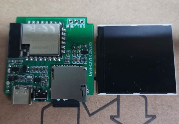

Liyue Core Board C3 Youth Edition (?)
This is the second shrunken youth version of Xiaozhazha’s Liyue core board
You can also take a look at what this design originally looked like before it went through two shrinks (fog): Github: libc0607/esp32-vision
Compared with the original design, here are the design goals:
  • Basically maintain the main functions of the original design (referring to video playback
  • The main control was replaced with a cheaper and easier to solder ESP-C3-12F module; due to CPU limitations, the frame rate was reduced a little
  • The components are all 0603 and do not require a heating table; the modules can also be soldered with a soldering iron to avoid module consumption caused by the heating table; and they are all basic libraries, and SMT can also control costs.
  • Optimize BOM, reduce component types, and reduce costs. This time you can buy them all from the same store.
  • Optimize the switch IC, it is too difficult to buy
  • Keep the double-layer board at 5mil/5mil 0.6/0.3, any board factory can use it
  • Added battery voltage reading, but due to insufficient IO, the charging status cannot be read.
  • No external antenna required for wireless functionality
  • Keep the indicator light/button/Type-C interface/TF card slot position so that there is no need to change its casing.
  • Use Type-C to download directly to avoid group friends from consuming a large amount of serial port modules.
The code is on Github: libc0607/vision-c3-youth.
This pile of code:
  • Video playback function is retained, but will automatically loop
  • Added key switching function
  • The function of long pressing the button to turn on and off is retained, but it is implemented through software
  • The TF card has been shrunk and only about 3M of internal storage is used.
  • But added Wi-Fi upload function
  • If the Bluetooth cannot be plugged in, it is not plugged in.
In short, the cost can be reduced relatively low, and the protocol is relatively open, making it more suitable for batches. (
Since this design is based on the design of Xiao Zezha, it is also open source based on the GPL 3.0 agreement (commercially available);
but the author does not guarantee the reliability of this design. You are responsible for the nature and possible losses, please evaluate the risk by yourself; The author reserves the right of final interpretation of the original part
