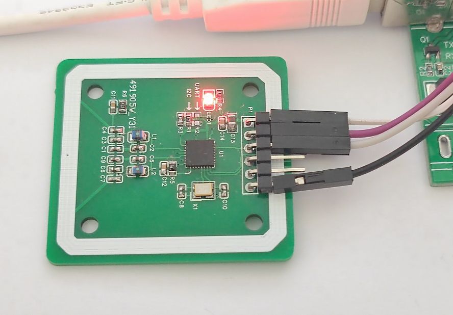

I bought a POS machine from Laowang Electronics next door for two yuan and a half. When I took it apart, there was a lithium battery, a screen, and a buzzer. There was no data on the main control, and there was no data on the Bluetooth chip. The silk screen of the NFC chip was worn away. I guessed that the NFC is MFRC522. After comparing the wiring and the data sheet, I found that the pins of the antenna part were the same, so I removed it and soldered it to the RC522 module. I guessed it right!

circuit
Since the UART and I2C pins are the same, it can be directly made into a UART and I2C multiplexing module. Connect the EA pin to low level and use the I2C pin to select UART or I2C.
Select I2C or UART mode through R1 and R2.
PCB design
Select UART or I2C mode by soldering R1 or R2 on the PCB. You can see on the back of the PCB that the UART and I2C pins are multiplexed.
Among them, U1, L1, L2, and X1 are removed from the POS machine.
NFC coil under white box
test
Passed the test using Arduino+MF522_I2C library
Read card information
