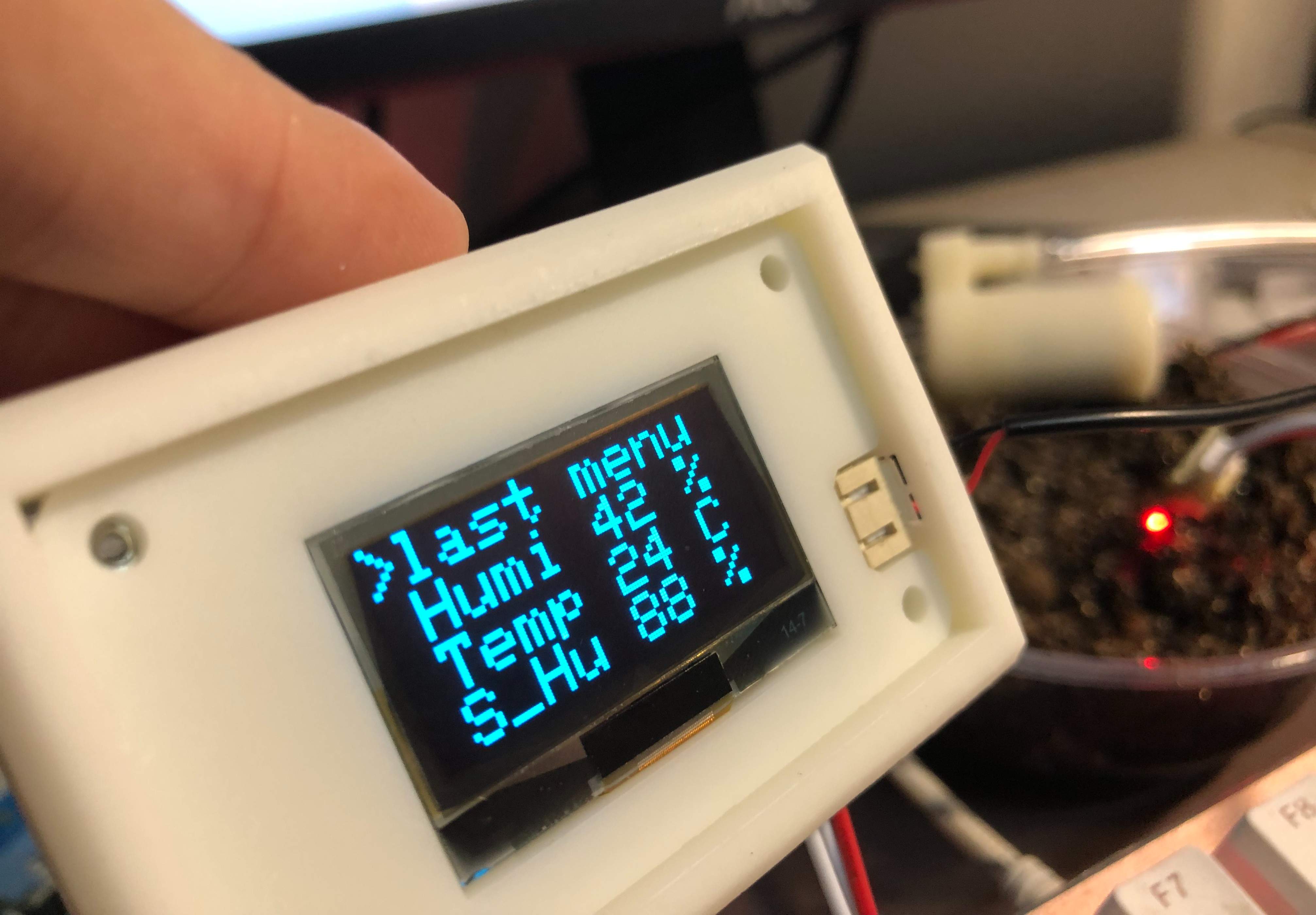

Adopt N32L403KBQ7 master control, ESP8266 as networking device, can choose to use it without networking or networking, and can adjust control parameters when not connected to the network
Update:
1.Bug: ESP8266 does not work, it may be a problem of hardware reset circuit not being done well, so the networking part may have to be suspended for a while.
2. BH1750 ADI is not pulled up to VCC (fixed)
3. There is a little bug in the battery power detection.
The functional block diagram is as follows.

Shell initial makeup
. I. Introduction to the functions of each module
1. Master control
  In order to improve the battery life without connecting to the power supply, the low-power N32L403KBQ7 master control is adopted. The main functions are: collect and process data, process images, send data to ESP8266, and detect battery power. Remember! BOOT0 is not brought out, and can only be downloaded through SWD.

7. The power management and charging module
  uses a pmos tube for power management. When there is no power (VBUS) input from the USB, a weak pull-down resistor makes the gate at a low level. At this time, DS is turned on and powered by a lithium battery. When there is USB power, VBUS will power the system through a Schottky diode. At this time, DS is disconnected, so that the system can be powered while charging. If you don't understand it very well, you can go and watch the video of Mr. Sun, a male engineer. The charging part uses a lithium battery power management chip. LTC4054 is an enhanced version of TP4054 (?), and its functions are similar to TP4054, so I won't go into details.
8. The water pump
  is just an ordinary 3V mini water pump. I can only say that it works. 9.   Solder the copper nut
on the fixed part 2. The inspiration for the project   "Pole Star Project" is my dream of designing a smart home (control) by myself, a complete set of IoT interactive devices and control devices, just beginning. (It's not God who forces me to do it) 2. Hardware   1. The power supply   uses two AMS1117s to power ESP8266 and MCU and devices respectively. The star connection is used to separate the power supply to avoid the AMS1117 from heating up seriously when the ESP8266 is in high power consumption, resulting in inaccurate temperature measurement. The battery power supply uses RC filtering to effectively reduce low-frequency noise. The coexistence of charging and discharging has been explained above. 2.   A 1nf capacitor is added to   measure soil moisture to stabilize the data.  3. The ESP8266   crystal oscillator is grounded, there is no wiring under the antenna, and there is a delayed start. All parts are strictly in accordance with the requirements of the technical manual. 3. I2C has added a pull-up resistor to greatly support external I2C devices. 4. Because the dial can be set to a pull-up state inside the chip, the dial state can be detected when the pull-up input is input. 5. The battery power detection adopts a switch type to avoid unnecessary power consumption. 6. The water pump drive uses PWM to drive MOS speed regulation, low conduction, and adjusts the water pump horsepower through the timer output of different duty cycle PWM. 7. There is nothing much to say about reset. BOOT0 is grounded through a pull-down resistor and directly enters the system flash. NRST pulls up to start normally and resets to ground. 8. Charging module 9. The short-circuit point is short-circuited, using the short-circuit point, and selecting USB serial port debugging. 3. The software part  is divided into eight parts for implementation. 1. UI   The UI is actually a nesting doll. Create a main linked list as the parent object, and then include the child object (actually also a linked list). When you click OK and the child object is not empty, it points to the child object. When you exit, it points back to the parent object. For details, please refer to this article. The idea reference comes from this article (@snqx-lqh) . I have commented on most of the code. The linked list is as follows, and the comments have been made. When creating an object, strictly follow the following format. The establishment of the menu is the same as what I just said, nesting dolls! Create an object. This object can be a parent object or a child object. The meaning of a child object is that it is included by this parent object. When the child object is clicked, it enters the linked list of the child object. At the same time, this parent object may also be a child object of another object (hence the nesting doll). UI screen refresh The UI screen refresh is controlled by two functions, one is the menu page refresh, the other is the data refresh Menu page refresh Data refresh UI control When the button is triggered, turn to the corresponding linked list. For details, please see the source code 2. OLED driver This driver is taken from B station UP host Mjgame. It mainly drives the graphics library and various graphics interfaces. The only disadvantage is that it cannot be used for inversion. 3. Soil moisture uses DMA to transfer ADC. I feel there is nothing much to say. After enabling DMA and ADC, the data will be automatically converted. 4. Ambient temperature and humidity
