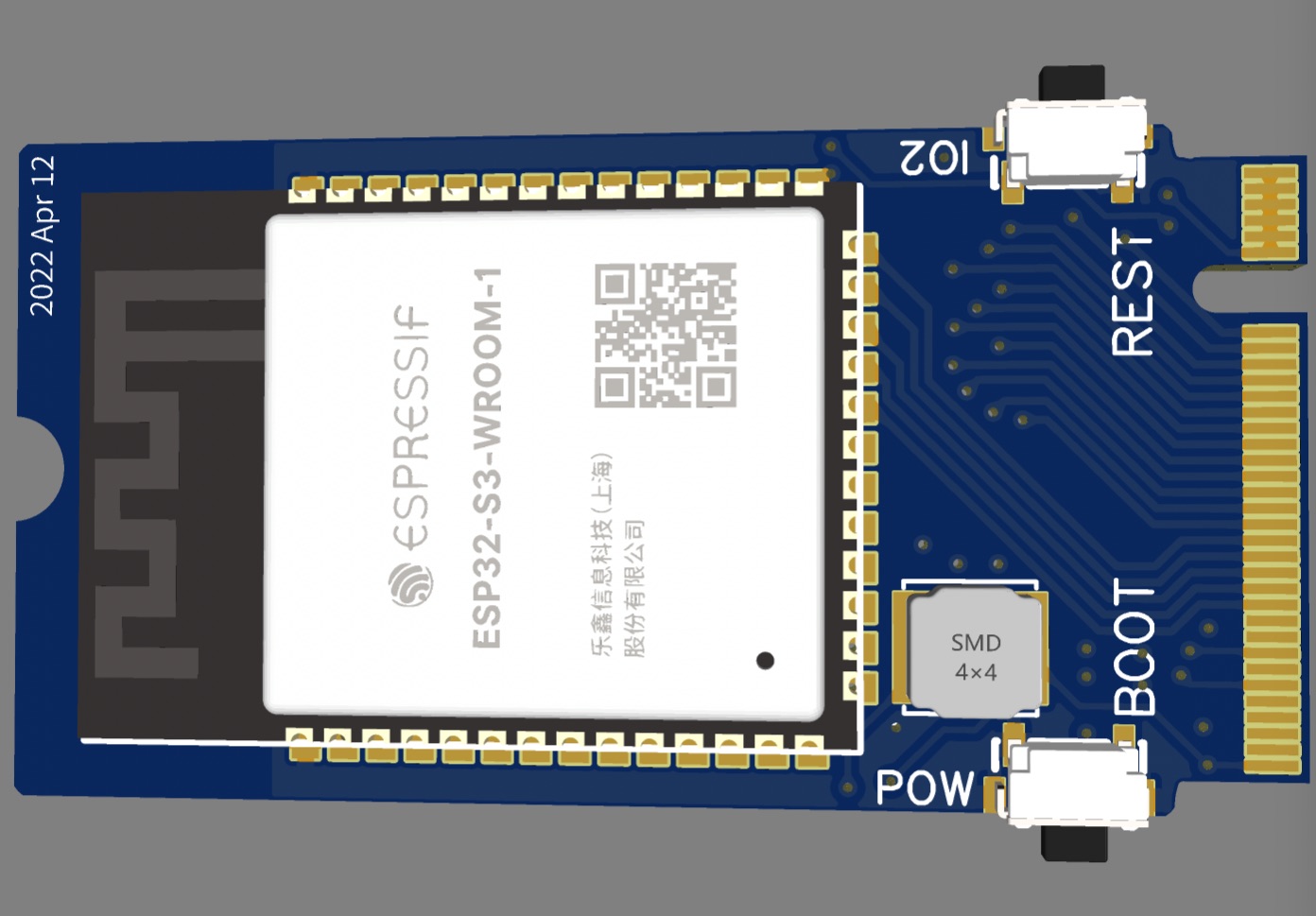

[Verified] Suitable for ESP32-S3 WROOM chip, be careful not to buy the wrong chip.
Burning requires a debugging board , no additional power supply and serial port chips are required.
Notion Project address
OSHWHUB Project address + m.2 interface encapsulation
This is part of my modular m.2 project, which has the following advantages:
1. Replaceability: It can be easily replaced between the same modules, or between different architectures Similar functions are implemented in the development version
2. Easy to repair: after a module problem occurs, the module can be replaced for debugging
3. Easy to upgrade: when there is a better design, it only needs to be compatible with the existing module and can be quickly deployed
4. Beautiful And structural stability: the structure is more stable, and it is less likely to cause errors due to connections
5. Cost reduction: modules and chips are reused between different projects (I am too poor to afford more chips)
I hope this modular project can bring you Some inspirations, and you are very welcome to create your own module under this pin definition!
