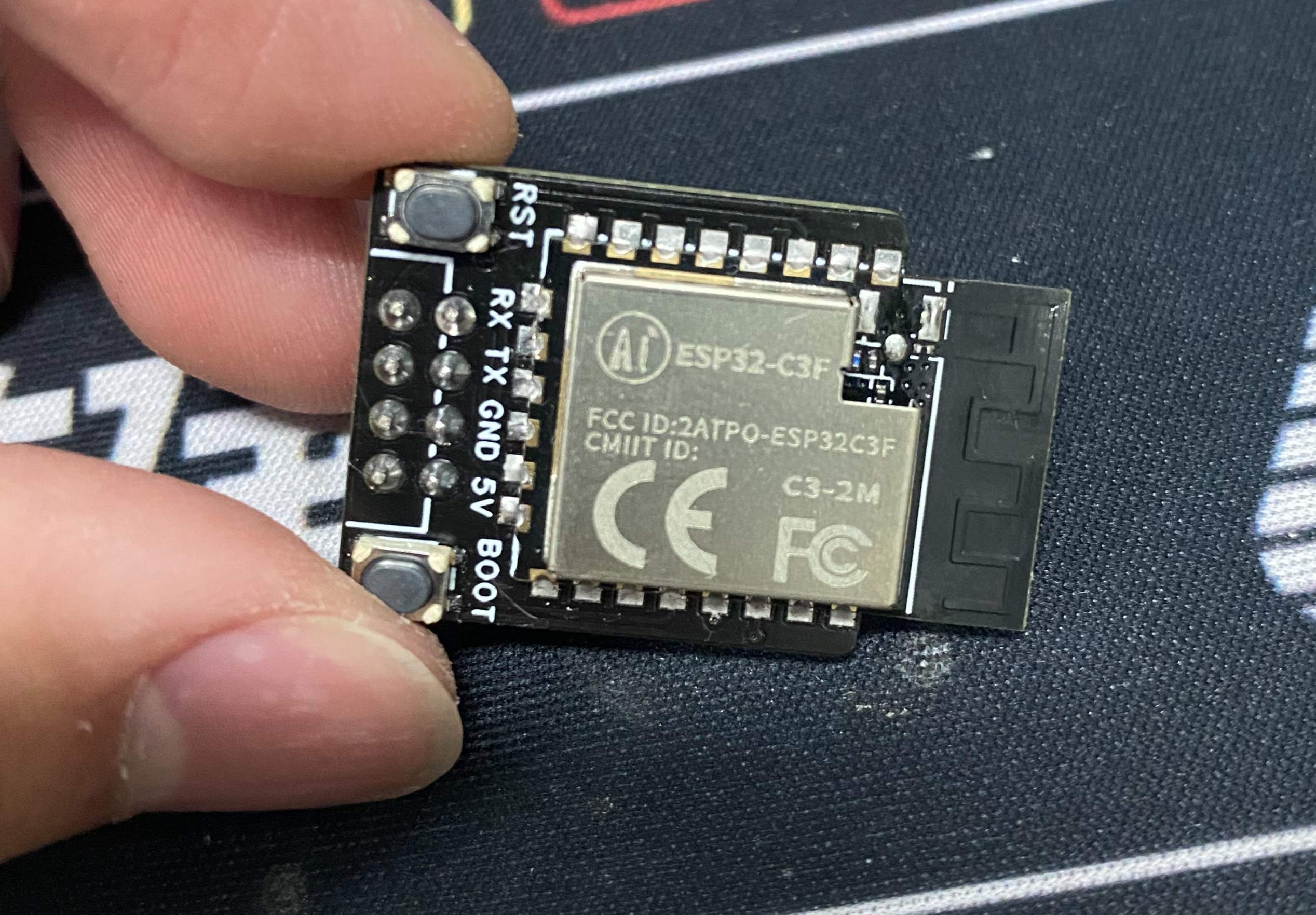

## Project Introduction
**This project adapter board supports two expansion methods. The first is a 2.54 pin header interface. The second uses a PH2.54 connector with power pins, serial port pins, firmware download pins, and EN module enable pins for easy switching.
The adapter board supports 3V-5V power supply and has integrated power conversion circuits.
Reset and BOOT buttons are reserved. When the BOOT button is in non-download mode, it can be used as a user button. **
**This project can be used for secondary development of itself, or for external MCU serial port communication development. It is convenient to transform traditional hardware products into IoT products. The module is small and convenient, and easy to expand. **

## Software Description
The adapter board reserves IO18 and IO19 pins, built-in serial port chip, one-click download, convenient for switching firmware.
The attachment provides AT command instructions and different versions of firmware provided by Anxin, which is convenient for switching.
![image.png] Update firmware:
![down.png] ## Physical display description
![esp32-c3.png] ![IMG_6186.JPG] ![IMG_6185.JPG] ![IMG_6183.JPG]
