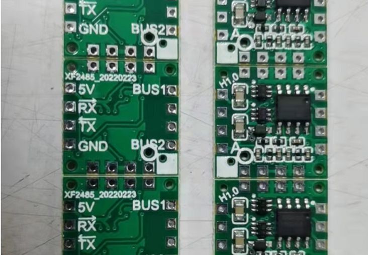

5 pin definition
Figure 2 XF2485 module pin diagram
Table 1 XF2485 module pin description table
pin |
name |
port |
illustrate |
1 |
BUS_P |
Bus input / output |
Bus port, no polarity |
2 |
NC |
Leave blank |
3 |
NC |
Leave blank |
4 |
BUS_N |
5 |
GND |
land |
Equipment power supply location |
6 |
XM_TXD |
Digital signal output |
Receive bus data, connect to the microcontroller serial port RX , pay attention to level conversion |
7 |
XM_RXD |
digital signal input |
Send data to the bus, connect to the microcontroller serial port TX , pay attention to level conversion |
8 |
VCC |
power supply |
Voltage input: 4.0V ~ 5.5V , 5.0V is strongly recommended |
