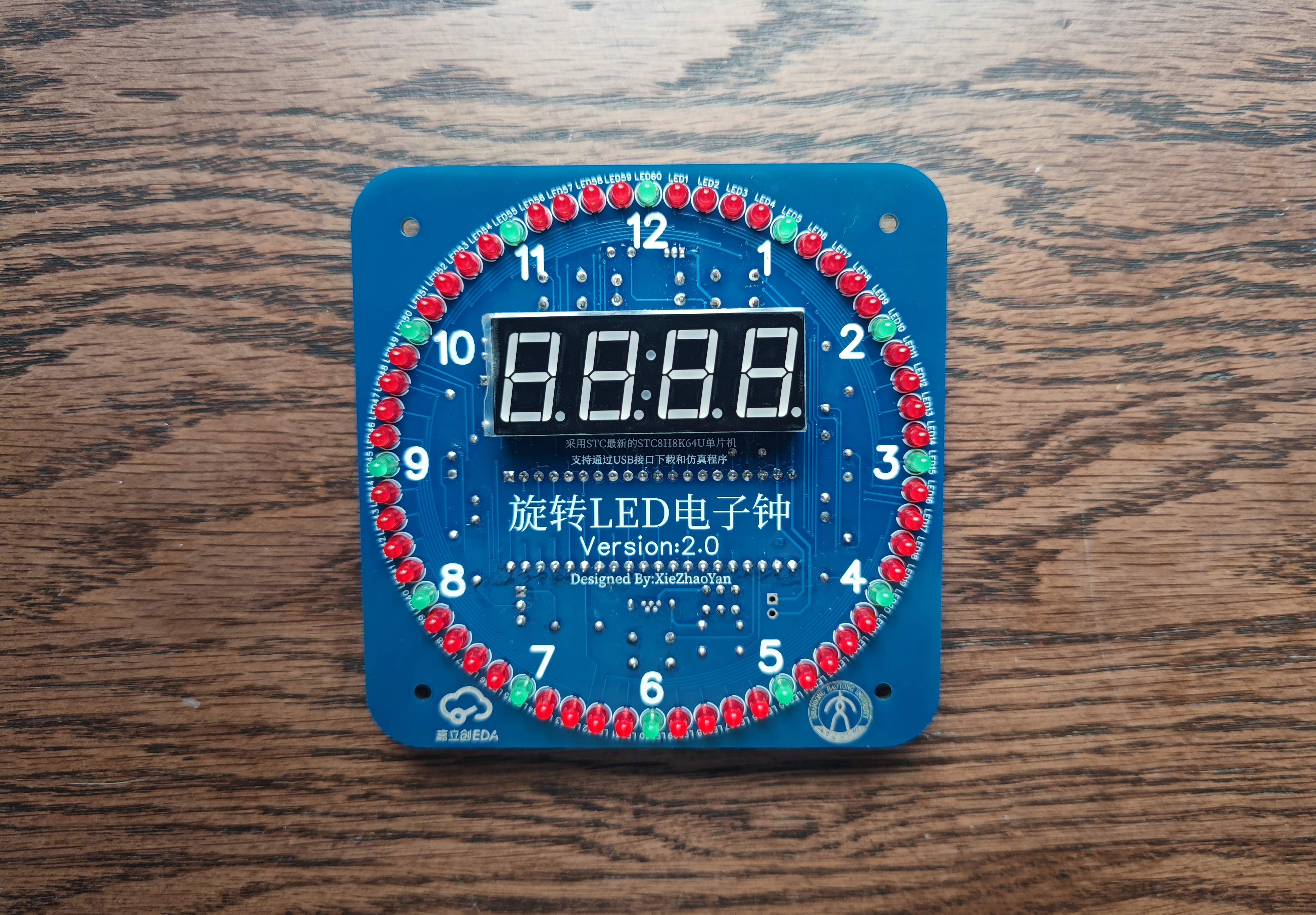

1. Project Introduction
        Electronic process internship program, choose plug-in devices. Rotating LED electronic clock, using STC8H8K64U microcontroller and DS1302 clock chip, 60 LEDs can change into various patterns. STC8H8K64U microcontroller is the latest microcontroller launched by STC. The most notable feature is that it can be directly simulated and downloaded through the USB interface. Therefore, the rotating LED electronic clock can not only be used as an electronic process internship program for colleges and universities, but also as a development board for learning STC microcontrollers.
         The V1.0 version of the project has been released for more than 2 years and has been welcomed by many friends. The project link: Rotating LED Electronic Clock-Jialichuang EDA Open Source Hardware Platform (oshwhub.com).
        In response to the suggestions and questions raised by netizens, after careful consideration, the second version was carefully designed and the following changes were made:
        1. The MCU was replaced. The microcontroller STC15W408AS used in the 1.0 version of the project is often out of stock by Lichuang. After a thorough investigation, we chose the STC company's single-chip microcomputer STC8H8K64U-45I-PDIP40. The reason for choosing the direct plug-in package is mainly to facilitate students' welding. Another advantage of the STC8H8K64U single-chip microcomputer is that it can be directly simulated and the program downloaded through the USB port. It is really convenient. This project can be used as a development board for learning single-chip microcomputers and conduct secondary development by yourself.
        2. The temperature sensor has an NTC temperature measuring resistor replaced with a DS18B20 because the DS18B20 has higher accuracy and can be debugged by simulating a single bus.
