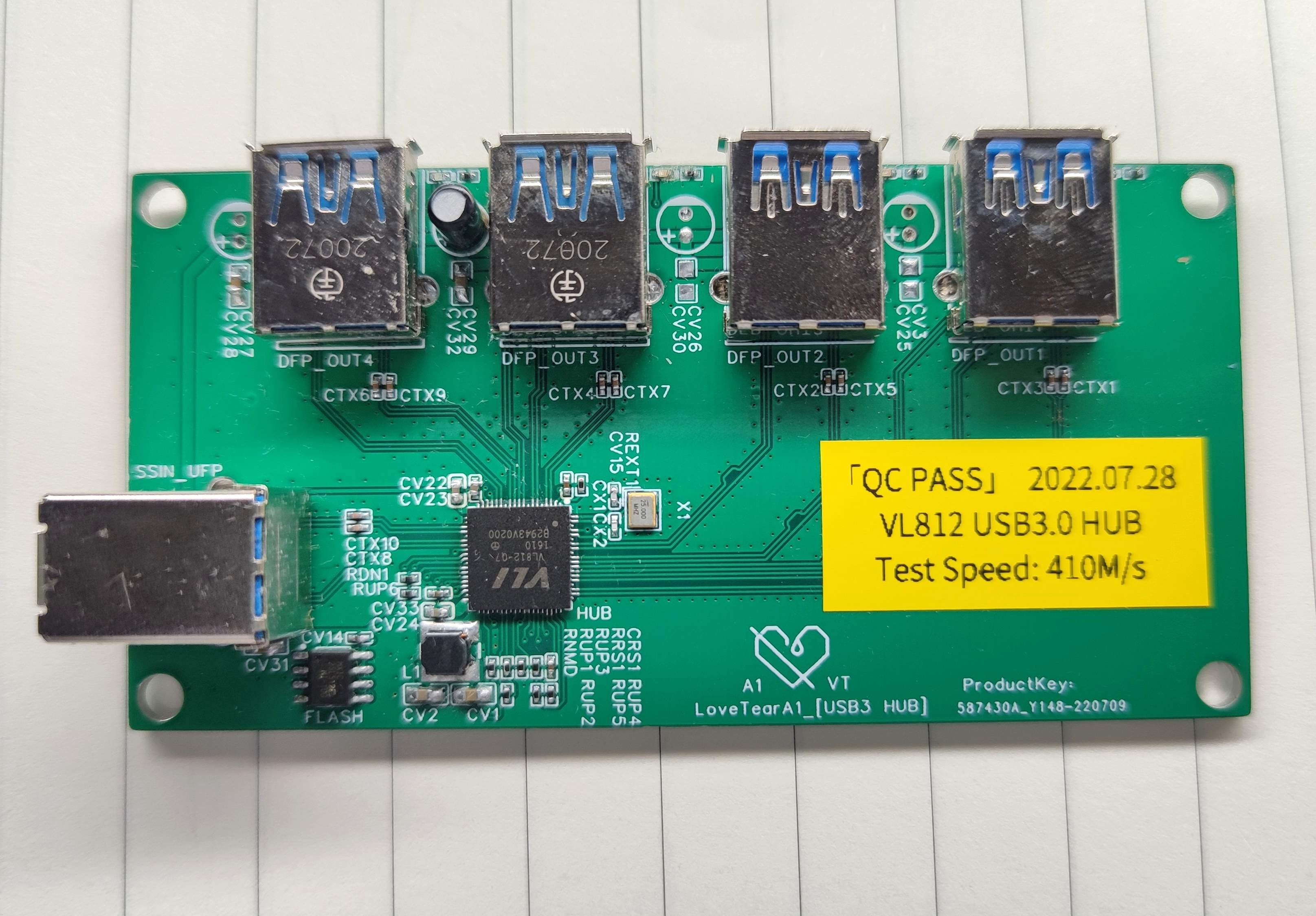

Use VL812 as master control
USB3 data and power supply are on the same port, using TYPE-B female socket
The input uses standard USB5V voltage (limited range: 4.5-5.5V)
Four USB3 outputs use TYPE-A female socket

The test speed is up to 410M long-distance running

2: LED light insertion detection
The corresponding LED lights up when the device is plugged in, showing that the device is being used (it seems useless, but the high-level indication can be used with other expansions)
After the ejection operation is performed, the LED will automatically turn off to indicate that the device has been ejected.
Other additional instructions for the docking station:
The wiring uses the 100R impedance on the Lichuang Forum, and the line width and line spacing are all 8mil.
Using JLC7628 structure, the inner layer does not need to be specially designated, and the USB3 signals are all on the outer layer!
VL812 does not need to rely on external firmware to run. Firmware is not required and can be run directly.
The board is 4 layers, but you can sample it for free
The cost of this docking station cannot beat the finished product on Taobao, which costs about 30-40 yuan (but after accumulating this valuable wiring experience,
Other styles of USB port layouts can be designed)
