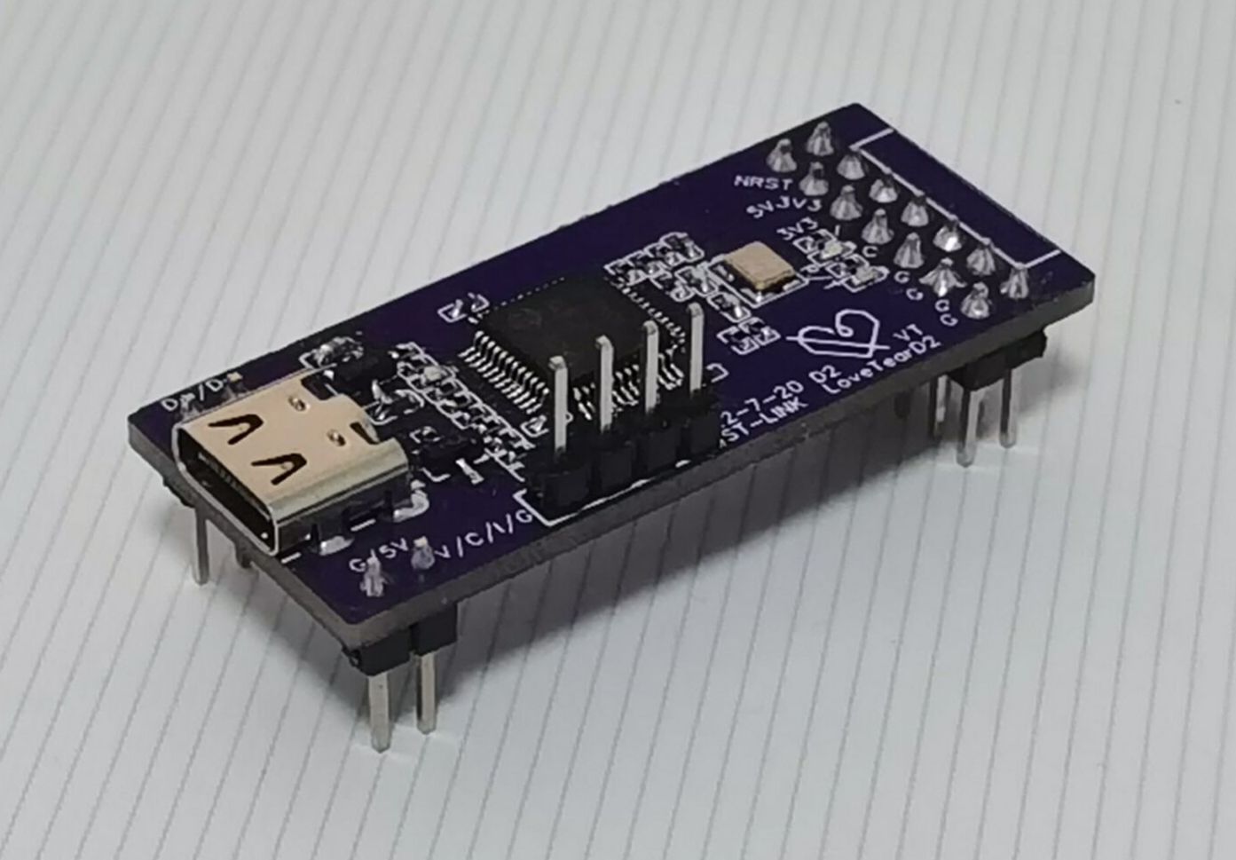

This ST-LINK uses TYPE-C port female input
The characteristic of this module is that the pin headers can be soldered to the in-line type to be installed on some modules. By reserving the corresponding header headers and their circuits on the board, the DuPont wire can be omitted.
Its 5V input, USB DM DP data, SWD CLK DIO virtual serial port RX TX, etc. can be directly connected through the vertical pin header and female connector to achieve operation.
This combination will be used on some self-made development boards in the future.
The functions are still the same, virtual serial port, debugging and development, etc.
For V2 firmware, use the suffix S4 (this version can burn F103C8T6, because the space of C8T6 is 64K)
For V2.1 firmware, use the suffix M18 (this version requires F103CBT6, which has a space of 128K)
A little bit of sorting out the resources required for firmware burning
(Updated on July 24, 2022) Use the new version of the file in the attachment, unzip it and click the corresponding bat file directly to burn. There is no need to configure environment variables!
