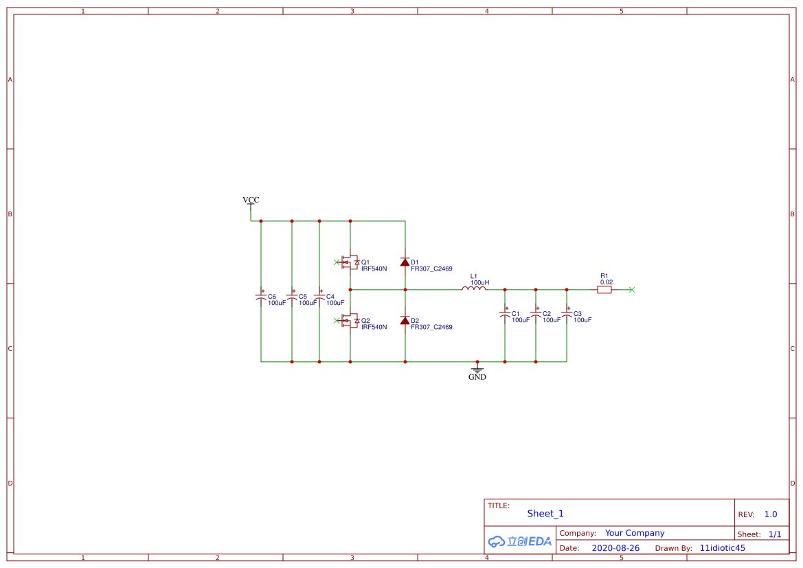

The two transistors IRF540 are respectively controlled by the microcontroller to realize the BUCK and BOOST of the circuit, and the required power resistors and switches are added according to the requirements of the question.
