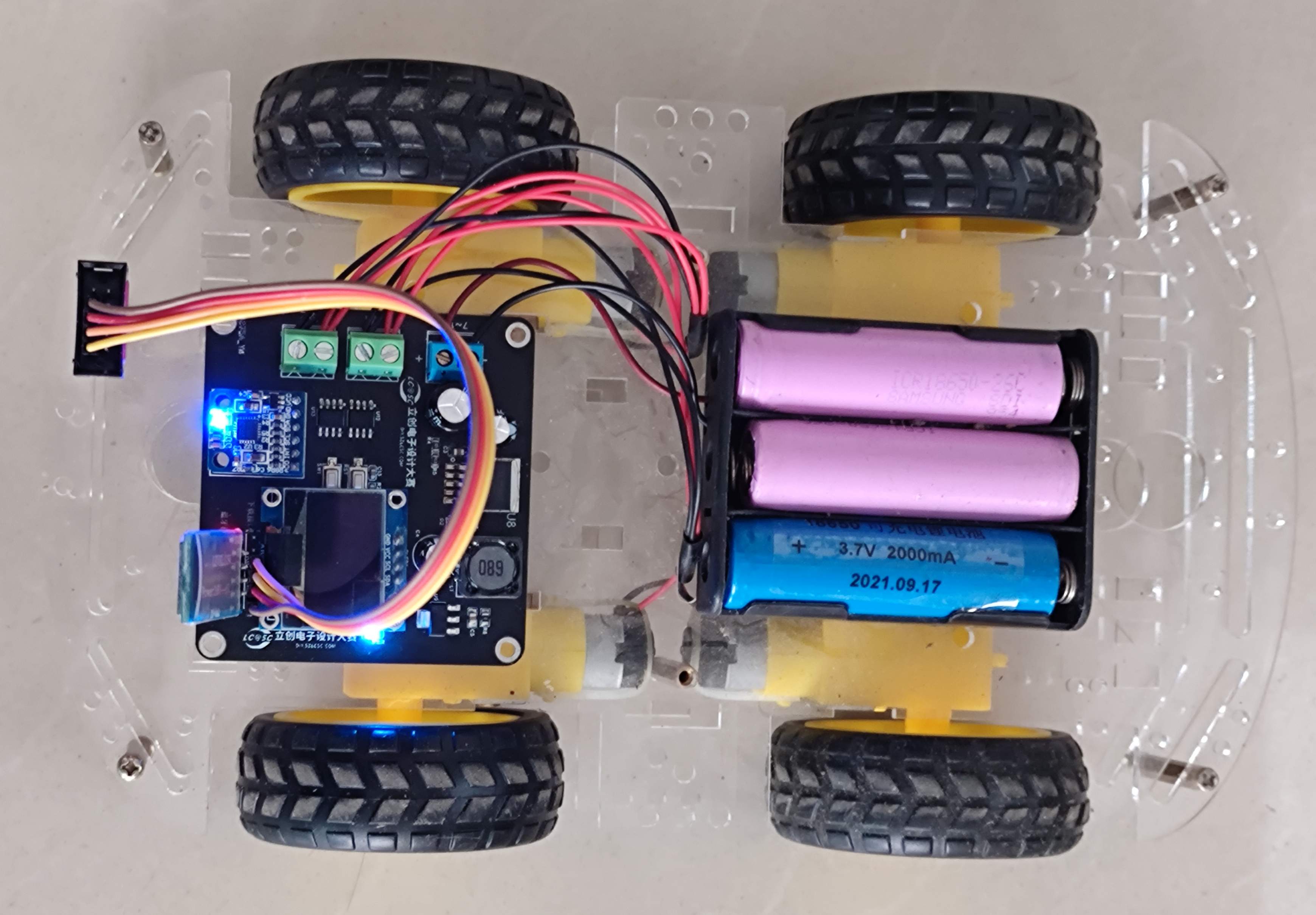

Use N32G430C8L7 to design a Bluetooth remote control car, the main functions are motor H-bridge drive, gyroscope information display, Bluetooth module interface, 0.96-inch OLED display interface.
The OLED screen is distorted or does not update because you bought a fake MPU6050. Fakes can be avoided: Taobao (XX City Yisheng Electronics XXXX). The program is stuck in the function of obtaining MPU6050 data.
Now use the MPU6050 module of Zhengdian Atom, and the original board is retained in the project.

The hardware part includes 15V to 5V to 3.3V power supply, motor H-bridge drive, MPU6050 gyroscope interface, Bluetooth module interface, 0.96-inch OLED display interface, buttons and LED lights.
*5. The software part
is limited by my programming level. Currently, there are only a few programs such as key lighting, pwm output, serial port sending and receiving, serial port lighting, and Bluetooth control of the car.
