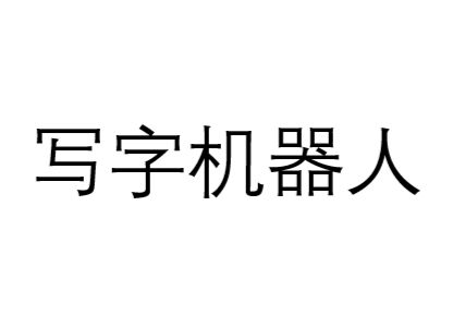

Font drawing effect
Above are the fonts drawn using Micro Engraving Butler, all of which are outline fonts.
This is a single line character drawn using ChiWi.
