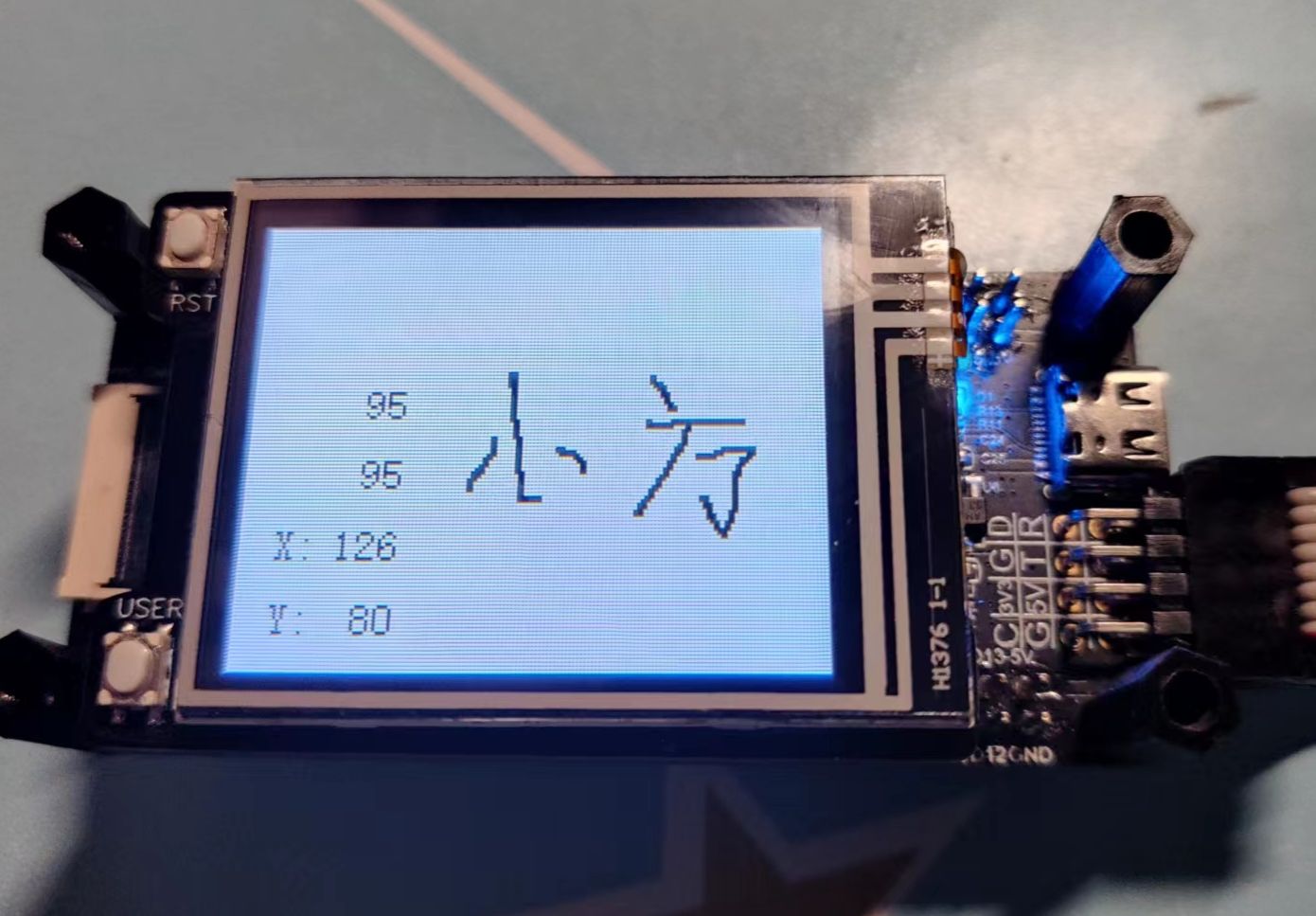

Boring_stm32h7_1.8 inch resistive touch screen
  Pin definition:
    PB3 ------> SPI1_SCK
    PB4 ------> SPI1_MISO
    PB5 ------> SPI1_MOSI
    PD0 ------> PEN
    PD1 ------>LCD_DC
    PD3 ------>LCD_PWR
    PD4 ------>LCD_RST
    PD5 ------>LCD_CS
    PD6 ------>TCS
Some of the original screen pins were changed and the screen selection was added back.
