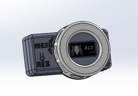

The The project can be used directly with the BLS_ESP 3D printer motherboard. The function has been verified to be normal. The BLS_ESP motherboard address is https://oshwhub.com/rcchen/blsesp.
The thickness of the board is 1.6mm.
The shell stl file is attached.
