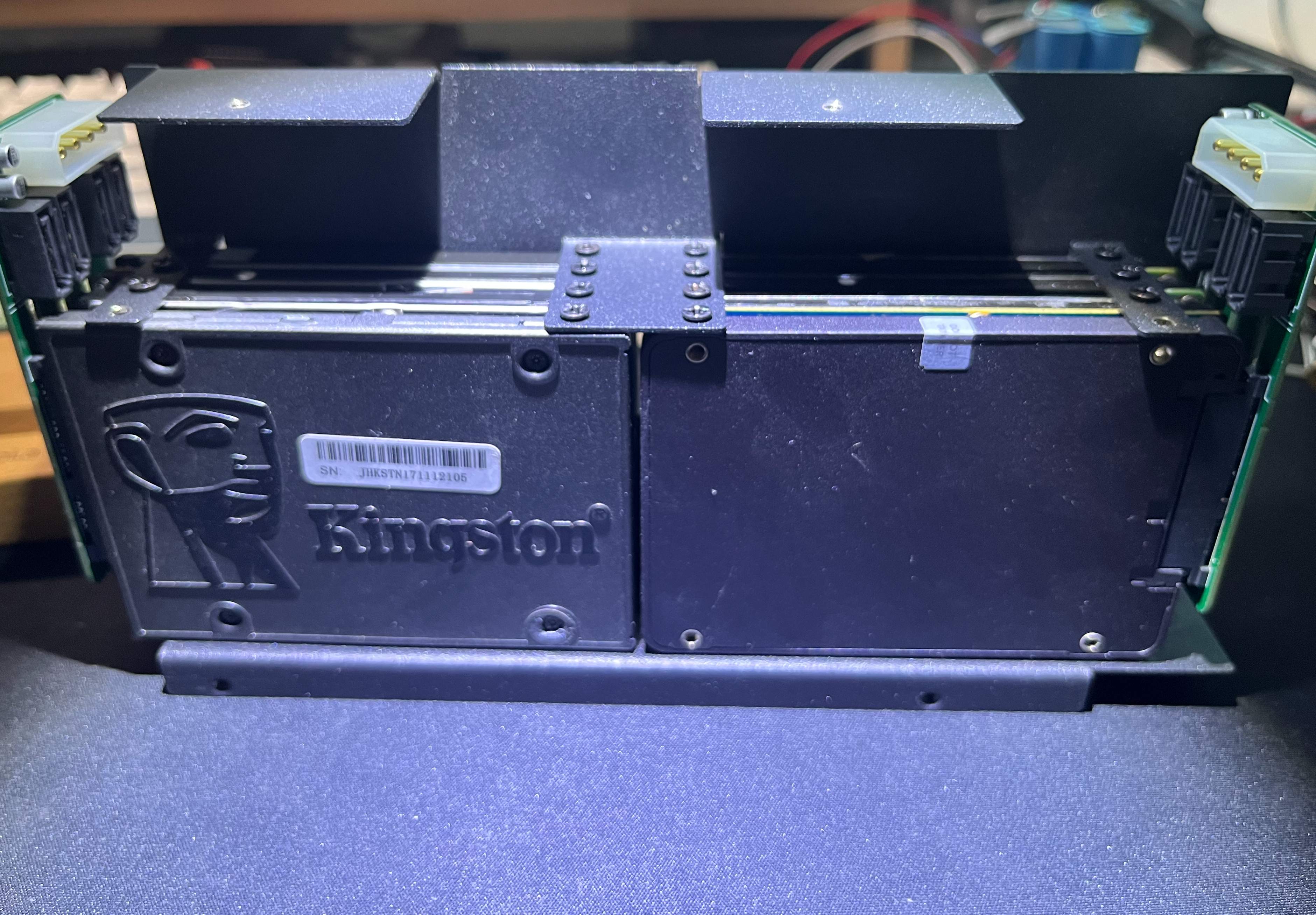

NBOX 2.5 SATA
**This 2.5 SATA backplane is only for NBOX formal DLC 2.5 SATA bit**
## suggestion:
1. Use 1.6 plate thickness;
2. After installing the 2.5-inch hard drive, install it into the NBOX chassis
## The following issues are currently known:
1. Only 7 screws can be installed on this backplane to fix the HDD/SSD. Due to size issues, only 1 screw can be screwed on the outermost HDD/SSD, and 2 screws can be screwed on the other three HDD/SSDs. This problem is cumulative. caused by deviation;
2. The differential pair routing part can also be optimized, and the existing version may have an impact on the speed (not verified);
3. It will affect the wiring space above the 2.5-inch SATA installation position, so you need to carefully decide whether to use this backplane;
4. After installation, it is difficult to add or remove 2.5-inch hard drives.
## Physical map:
参考设计图片
