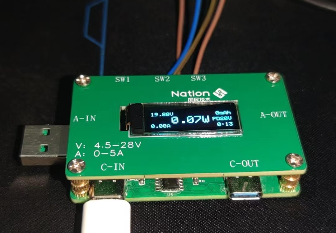

* 1. Project function introduction
This USB power meter based on the National Technology N32G430C8L7 MCU supports TYPE-C and TYPE-A power supply, input voltage 4.5V-28V, maximum current 5A (limited by the USB interface, over 5A for a long time will cause heat), with PD deception function (the power adapter must support the PD protocol), can trigger different output voltages by pressing buttons, and can be used as a small DC power supply.
It can realize the stopwatch function and calculate the total amount of power charged within the time (the actual measurement error is large, Figure 1 is happy).

PD deception uses Qinhengwei's CH224K PD power granting protocol chip, and deduces voltages of different gears by changing the CFG1-3 pin level. Xiaomi 30W adapter uses TYPE-C female port to decoy 12V, which has a temporary problem.
(7) OLED
This time, a separate OLED design is used, and the screen driver board and the main control board are connected through the FPC board-to-board connection line, which greatly saves space and makes the layout more beautiful. The screen driver design refers to the SSD1306 data sheet.

* 8. Physical verification
