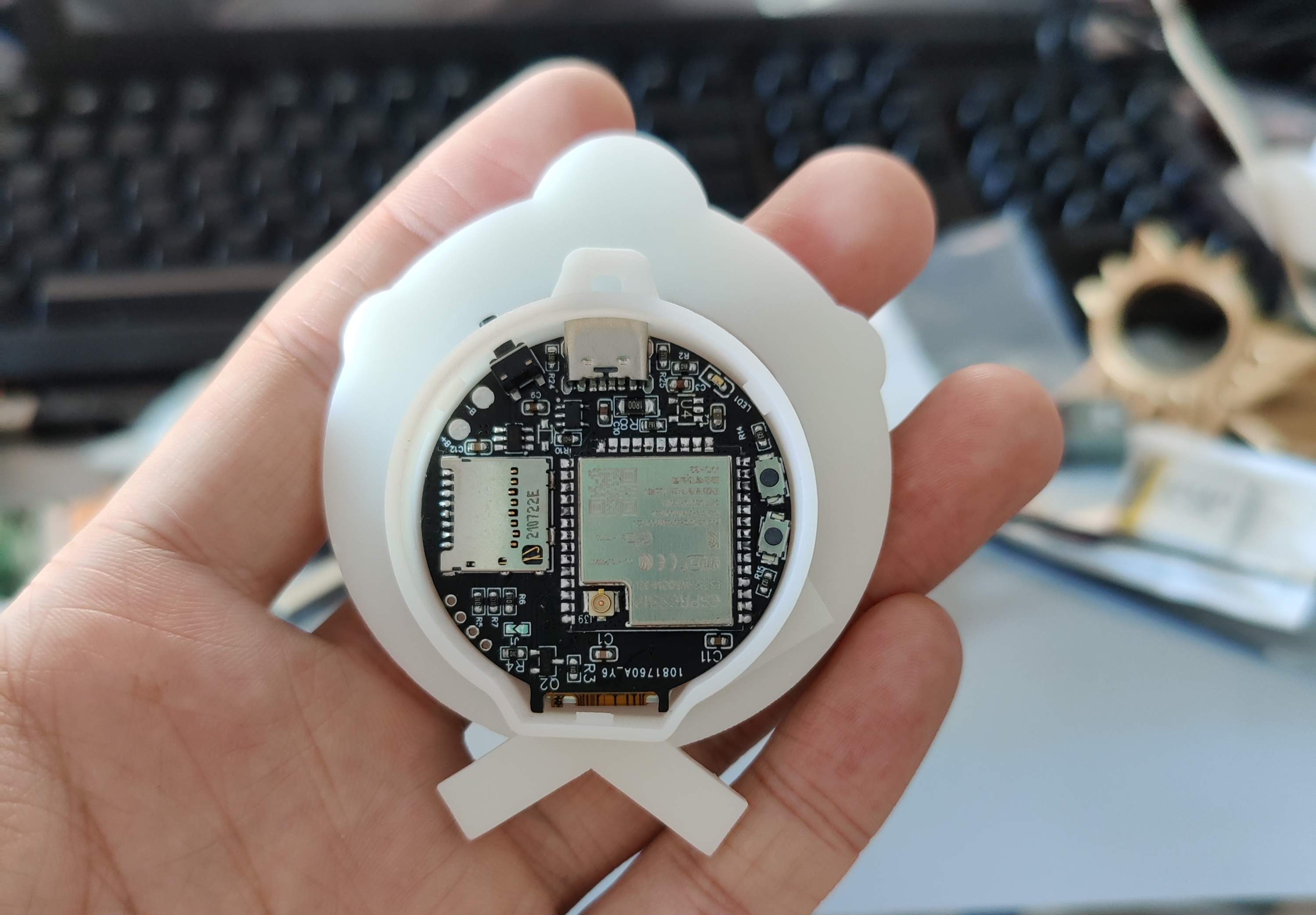

The original project was another project of mine. Since it used ESP32 Pico D4 and 0402 resistors and capacitors, it was difficult to solder, so I re-drawn a version that is easier to solder.
The main control is changed from ESP32 Pico D4 to ESP32-WROOM-32U module
Resistor and capacitance changed to 0603 package
The TF card slot is changed to 1040310811 (Lichuang Mall C number: C585350)
Shell thickness increased by 1mm
Please select 1.2mm for board thickness
The shell is 1mm thicker and has a buckle design, so it is not compatible with the previous version of the shell.

Since the screen back panel is made of metal, please use high-temperature tape to stick the cables for insulation after the screen is soldered.
