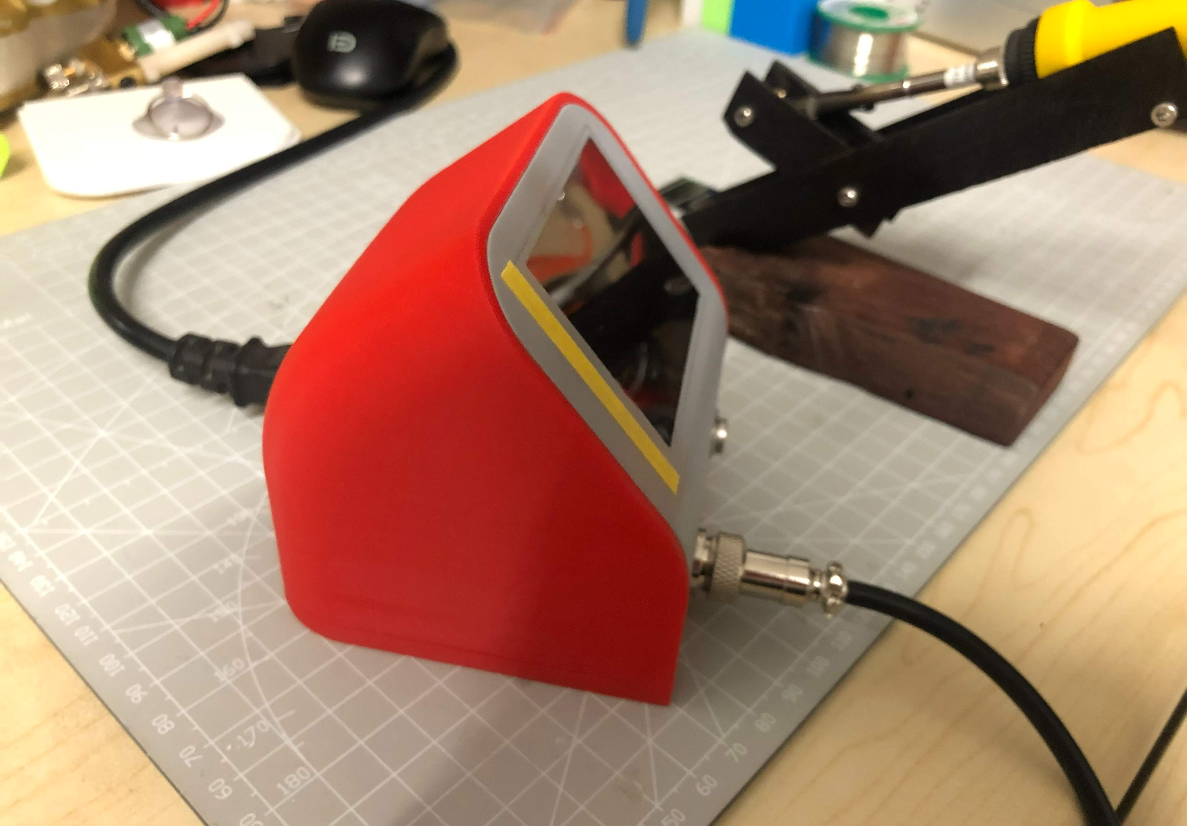

The shell is designed based on the open source touch screen T12 motherboard of the predecessor. For
the circuit part, please refer to the project of the predecessor: https://oshwhub.com/zhqsoft/shmictrl-28-t12
The motherboard is available on the official Taobao store.
advantage:
Cross-border temperature setting, 5 commonly used values can be set
Customizable interface
Legal Notice: No commercial use without permission.
Accessory parameters:
Power supply: Apple disassembled power supply
Power interface: plum blossom three-hole socket
DC interface: 5.5-2.1
Power switch: 12mm-lighted switch
Soldering iron handle interface: GX12
