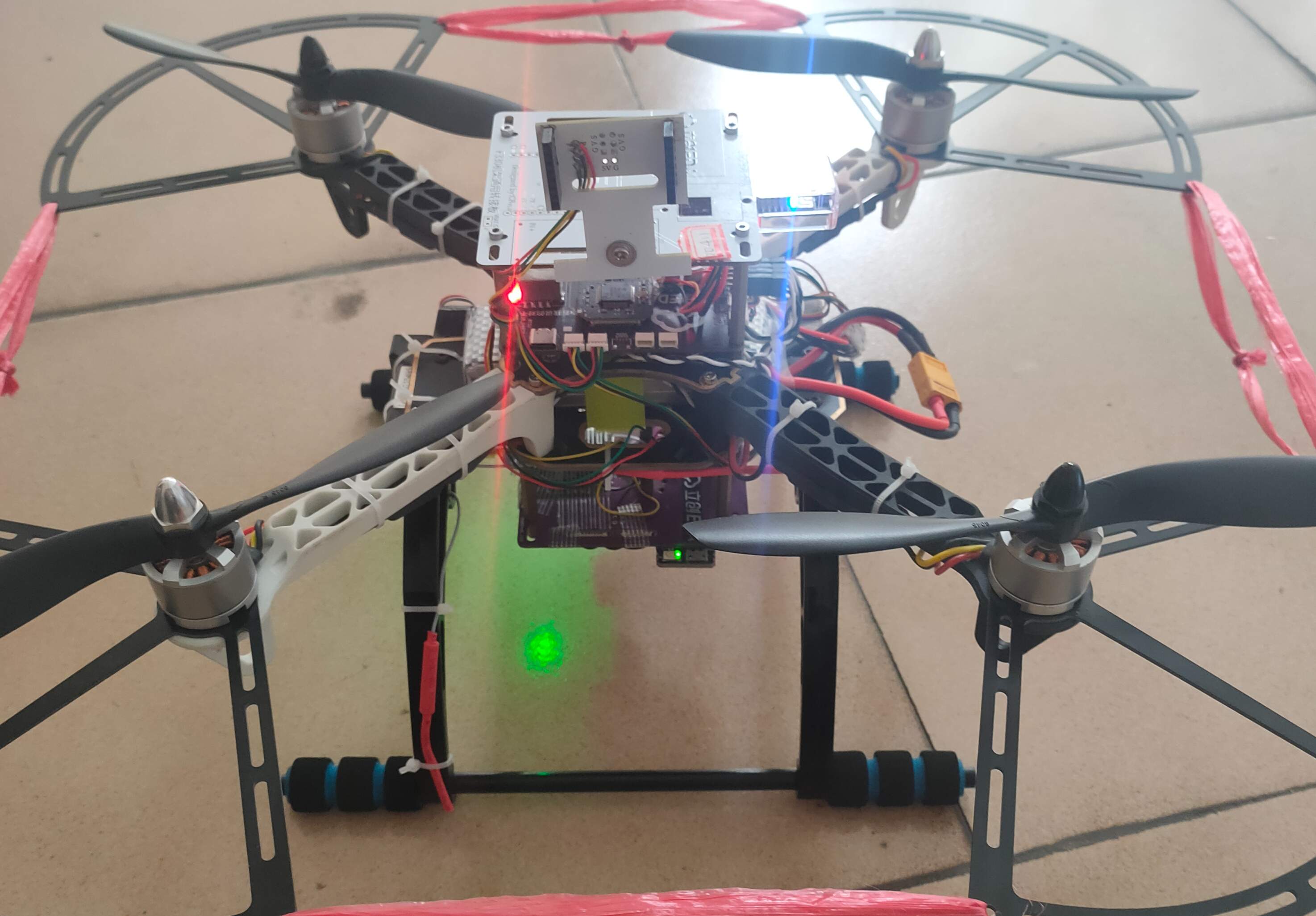

7. Physical display:
After the flight control board is welded, it is as follows:
Then there is the picture of the whole machine. This is before the competition. The ultrasonic wave on the side is what we use to wrap around the pole (2019 UAV question)
You can see that the flight control board can be installed just above the fixing hole of the F330.
8. Work assembly:
The rack we use is an F330 rack. Just install the flight control board on the top layer and fix it with screws. Other motors and propellers can be installed according to regulations. Things like propeller steering are the foundation of the foundation.
Then there are the optical flow, digital transmission, and ultrasonic accessories provided by Anonymous. They can be installed according to the Anonymous manual. You can refer to our installation method. OPENMV is connected to serial port 2 and serial port 3.
