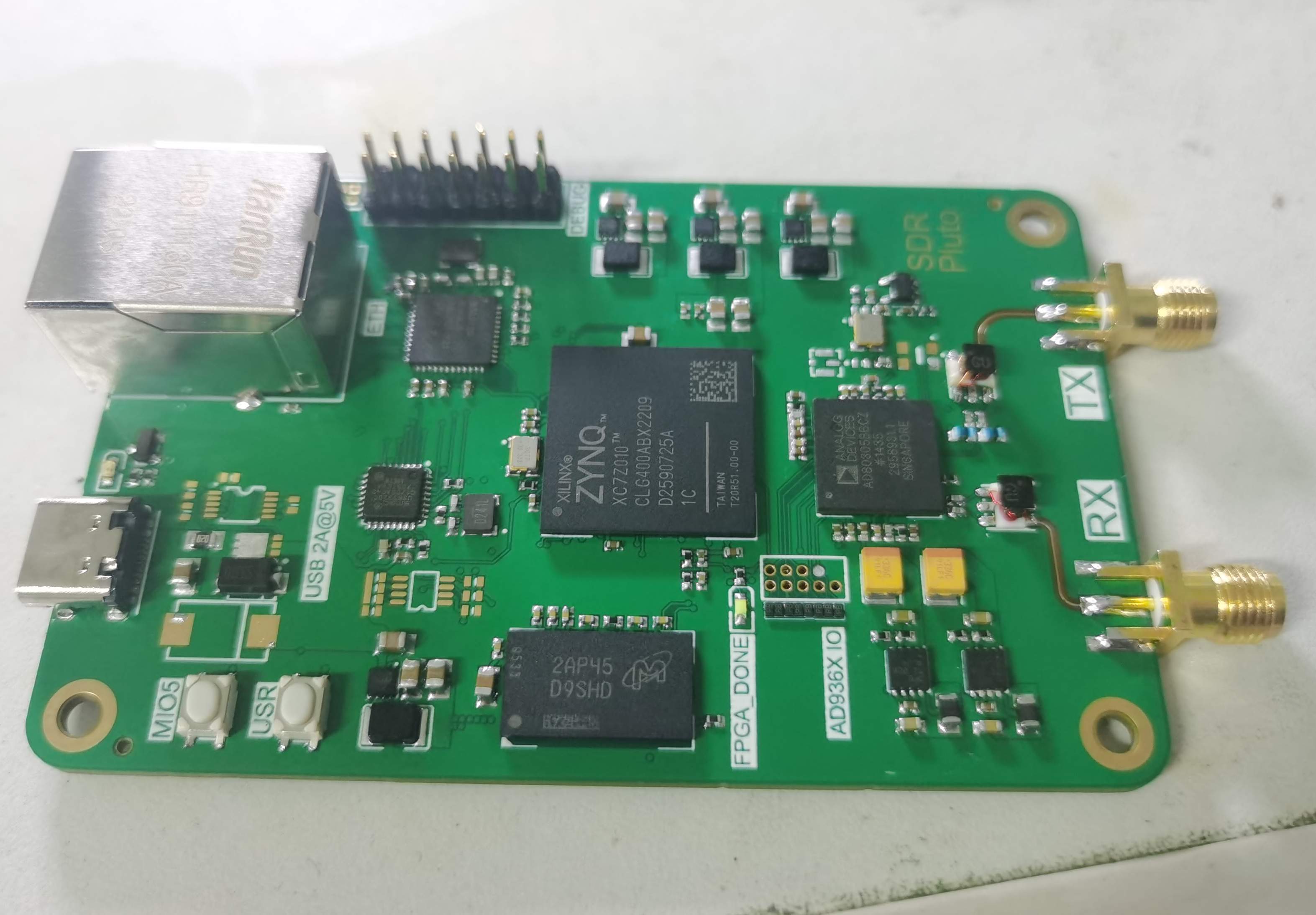

6-layer immersion gold version PLUTO SDR
Modified from https://oshwhub.com/Fanserasery/pluto_b50612
Pluto_B50612 - Jialichuang EDA open source hardware platform (oshwhub.com)
Notes:
            1. Please download the file in the attachment (AD23 format)
            2. The MPSOC model used is XC7Z010
            3. The power supply inductor model is CKST322512-2.2uH/M
            4. Do not solder C163 without soldering ADM1177 (U13)
            5. RF chips can use AD80305, AD9363, AD9361
            6. U10 and U11 are actually soldered TPS73601DRB (the current is small, it is best to use LD39200)
            7. The TCXO model is NT3225SA, choose one of Y3 and Y5
            8. Impedance selection 3313
Known issues:
       1. Neither TCP nor UDP can reach 500Mbits/s when measuring network card speed.
