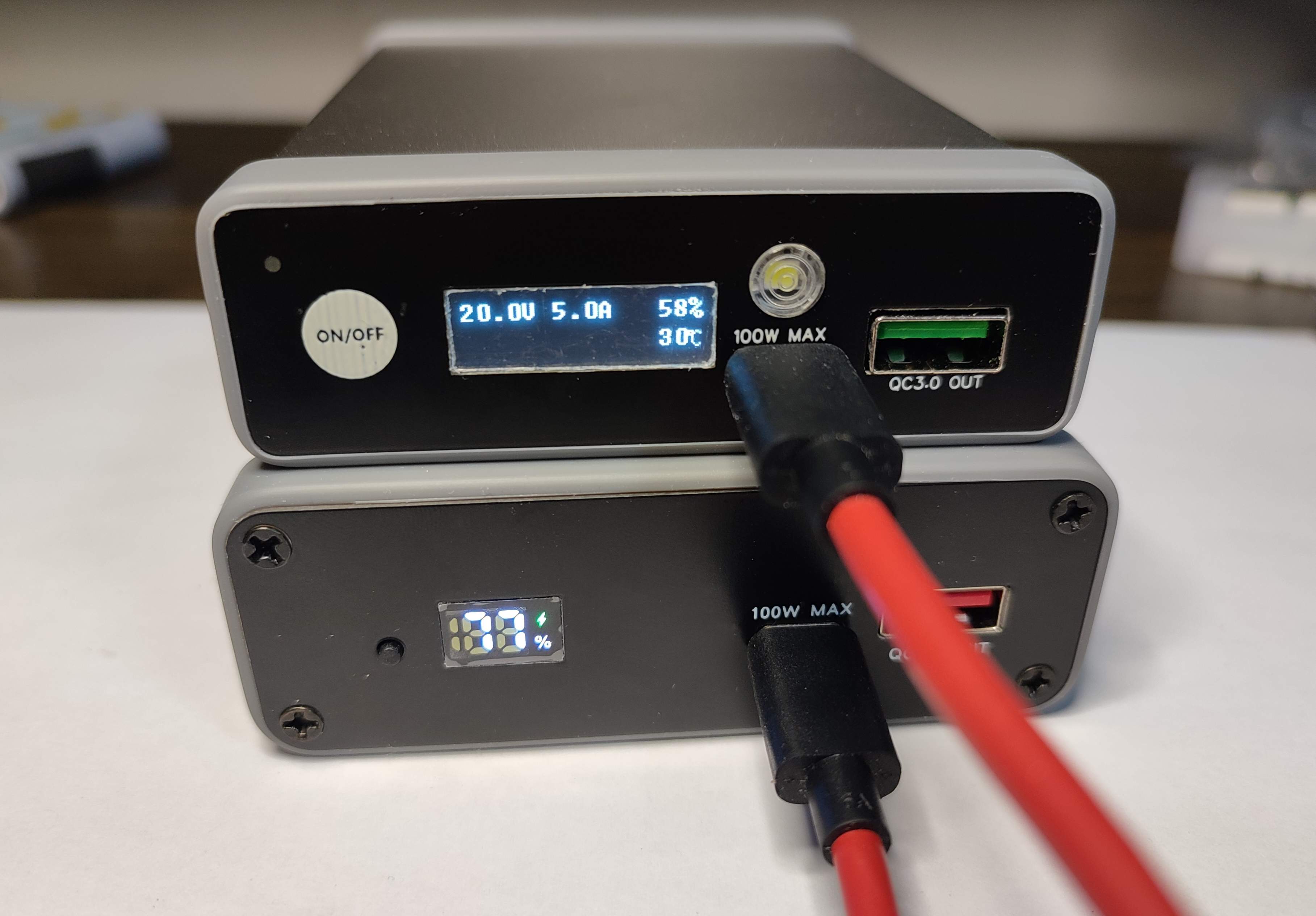

Screen display 100W fast charging power bank
Introduction
100W fast charging power bank based on IP5389 chip solution, with OLED display, which can display battery power and temperature, charge and discharge voltage and current; capacitive touch button switch with lighting.
characteristic
  • Using Yingjixin IP5389_I2C_AACC fast charging chip, it can realize PD two-way 100W fast charging
  • 4 high-rate 18650 batteries, integrated battery protection and balancing chip, with NTC high temperature protection
  • Integrated STM8S103 microcontroller and 0.91-inch OLED display, which can display battery power and temperature, charge and discharge voltage and current
  • Capacitive touch button with touch indicator light
  • With 0.2W lighting

OLED screen panel with 0.2W lighting
PCB panel, with STM8S103 microcontroller and TTP223 touch chip on it, the touch indicator light uses a side-mounted LED light.
The upper NTC is used for battery protection chip; the lower NTC is used for IP5389. When charging, if the battery is detected to exceed 45 degrees, IP5389 will automatically cut off charging; the cable is too long.
Add a piece of 1.5MM foam glue between the battery and the motherboard. During installation, you can directly press the panel to push the battery in.
Put a layer of tape on the inside of the PCB panel to increase the insulation of the PCB traces.
Be sure to add a thermally conductive silicone sheet, otherwise 100W charging and discharging will cause the motherboard to become seriously hot. Even if a silicone sheet is added, long-term 100W charging and discharging will cause the temperature inside the case to exceed 45 degrees, and the motherboard will automatically shut down for protection.
There is basically no problem in downgrading to 60W.
Charging voltage and current display
Discharge voltage and current display
The light needs to be turned on and then pressed and held for 2 seconds to turn it on. When it is turned off, it also needs to be turned on first and then pressed and held for 2 seconds to turn it off. Why can't it be turned on and off directly when the light is turned off?
I found a transparent plastic board, and after cutting it, the installation effect is as follows, which is better than nothing.
