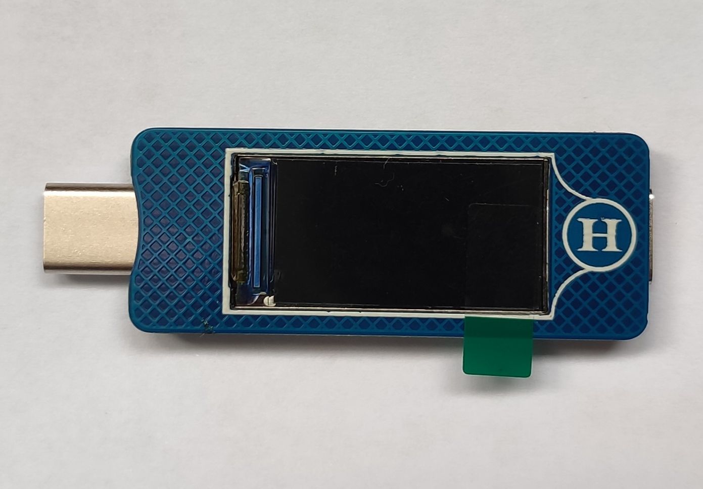

USB voltage and ammeter based on ESP32-PICO-D4+INA226, using TYPE C male and female connectors; touch button to switch display direction; focus: ultra-thin, simple
structure
Two-layer PCB board, installed through 2.5mm high M1.4 welded copper pillars, the total height after assembly is 5.3mm
characteristic
  • Based on ESP32-PICO-D4 chip, using INA226 for voltage and current measurement
  • Adopts 0.96 TFT display, which can display voltage, current, power and capacity (WH)
  • The input adopts TYPC male connector and the output adopts TYPE C female connector.
  • Currently only 5A is measured, the board will be a little hot.

  • The TYPE C male connector has no positioning holes, and the pin spacing is smaller than that of the female connector, making it not very easy to weld.
  • I originally wanted to use an independent touch chip on the panel for the touch button. Later, I tried to use the touch pin of ESP32 to connect it. It also works, but the sensitivity is not that good after passing the flying wire. In addition, there is also a touch button reserved on the back of the base plate.
Plate thickness 1.6mm
Outer frame PCB board thickness 1.2mm
When welding copper pillars, use a file to flatten the protruding solder legs. If you don’t want to be so troublesome, leave a hole in the panel.
Solder the wires of the touch buttons. I originally wanted to use POGOPIN, but one costs 2 yuan and 8 yuan for shipping. It is not cost-effective. I will use wires instead for the time being.
