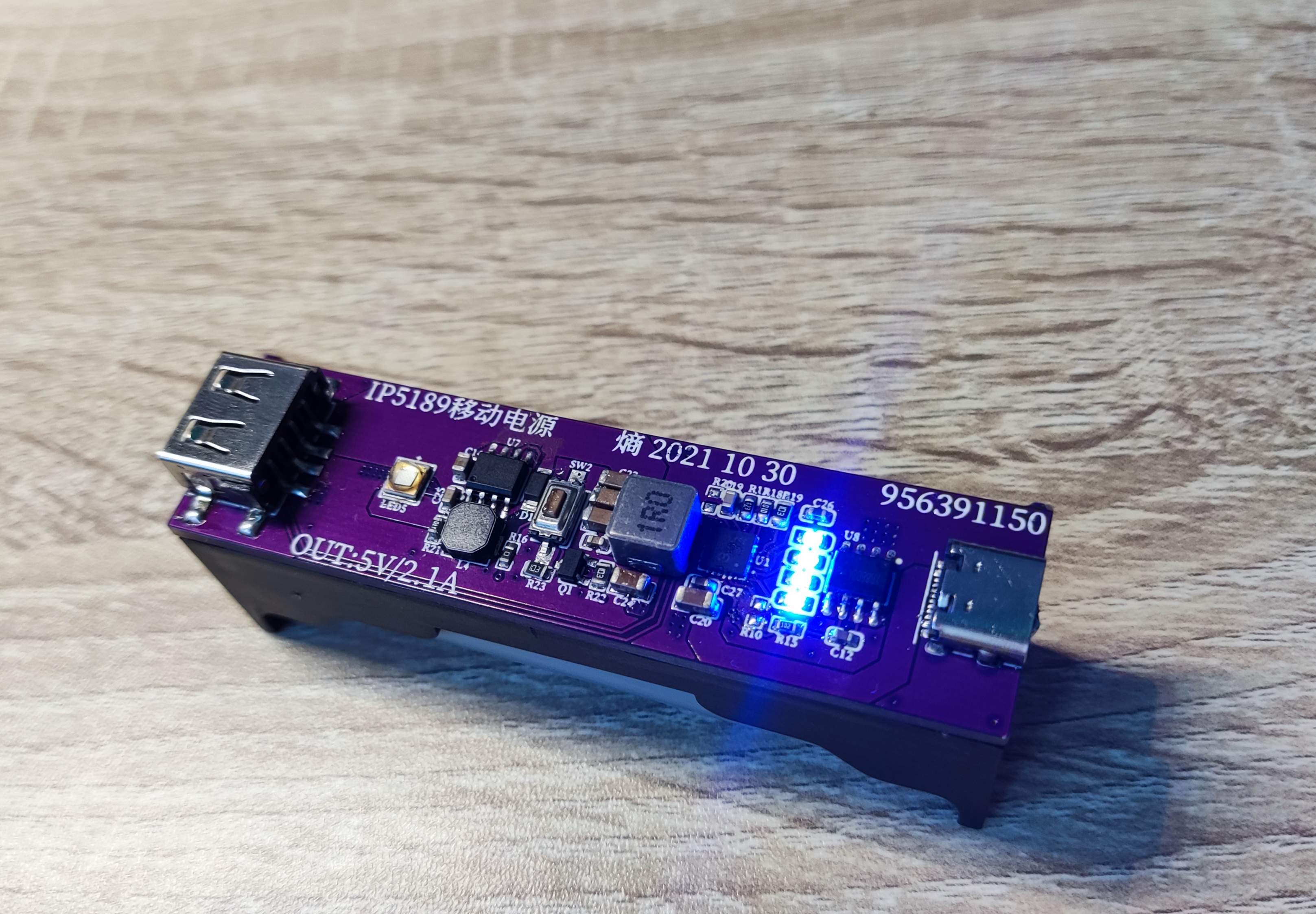

IP5189T: Board verified and available
The integrated high-power constant current driver chip is used to drive 1W UV lamps (can drive up to 5W lamp beads) and controls the switch through the IP5189T button. Since there is no 18650 SMD battery box, a direct plug-in design is used. When welding, pay attention to the insulation between the TYPE-C female socket and the negative electrode of the battery holder (if you do not want to lose the protection function)
