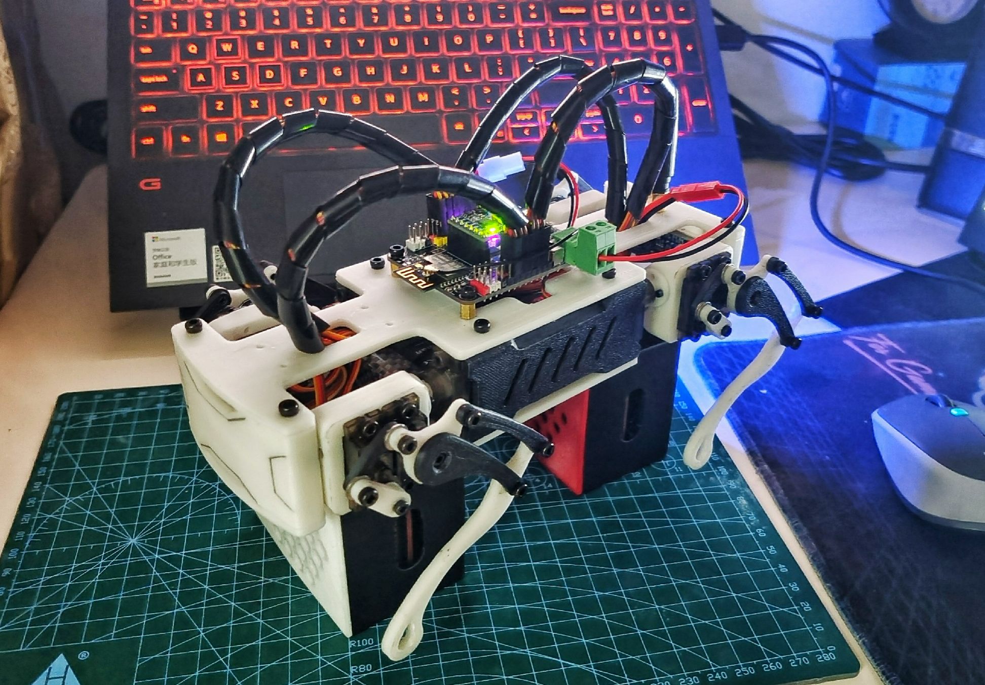

1 Project Introduction
   本项目中设计了一款基于鸿蒙Hi3861主控的十二自由度桌面级舵狗,选择MG90S型号9g舵机作为关节位控电机,采用PCA9685PW来实现16路舵机的驱动控制,具有MPU6050六轴加速度传感器模块接口。
移动电源为2S-35C航模聚合物锂电池,电机供电部分采用以MP2236型号DC-DC芯片展开的BUCK型DC-DC降压电路,其支持宽电压输入,最高输入电压18V,最高输出电流6A。

3 Mechanical structure design
设计软件:SolidWorks 2020
所述十二自由度四足舵狗总重量:570g
单腿采用并联腿结构,电机安装部分结构及单腿结构设计紧凑,以尽量减轻腿部重量与节省空间。
主要结构件部分均采用了FDM式3D打印,材质为PLA,大部分均可无支撑打印。

7. Physical pictures
Existing Problems
1. In this project, the quadruped robot's hind legs are weak when it stands while lying down, and when the Trot moves forward and backward. It is speculated that it is due to insufficient torque of the MG90S and quality batch issues.
(Replacing [a better steering gear] is expected to solve the problem);
2. The deviation of each single leg of the robot needs to be calibrated before moving, which is cumbersome and time-consuming, that is, the steering gear control accuracy problem.
(Replacing [a better servo] may solve the problem);
3. During the movement of the robot, the height of the left and right legs is not equal, which is also a debugging problem involving the accuracy of the servo.
(Replacing [a better servo] is expected to solve the problem);
4. Some of the servos in the robot are shaking wildly after performing actions, which means there is a quality problem with the servos or a power supply problem (there should be no problem with insufficient power supply on this board).
(Replacing a [better steering gear] may solve the problem);
5. The bolt connections of the robot's single-leg mechanism are prone to being too tight or loose, causing the single-leg mechanism to become loose or difficult to move. The current optimization plan is to repeatedly move the hand-pull mechanism to destroy the internal threads of the printed parts and ensure smooth relative movement between parts.
(Adding [miniature bearings] to each joint of the single leg is expected to solve the problem) √
