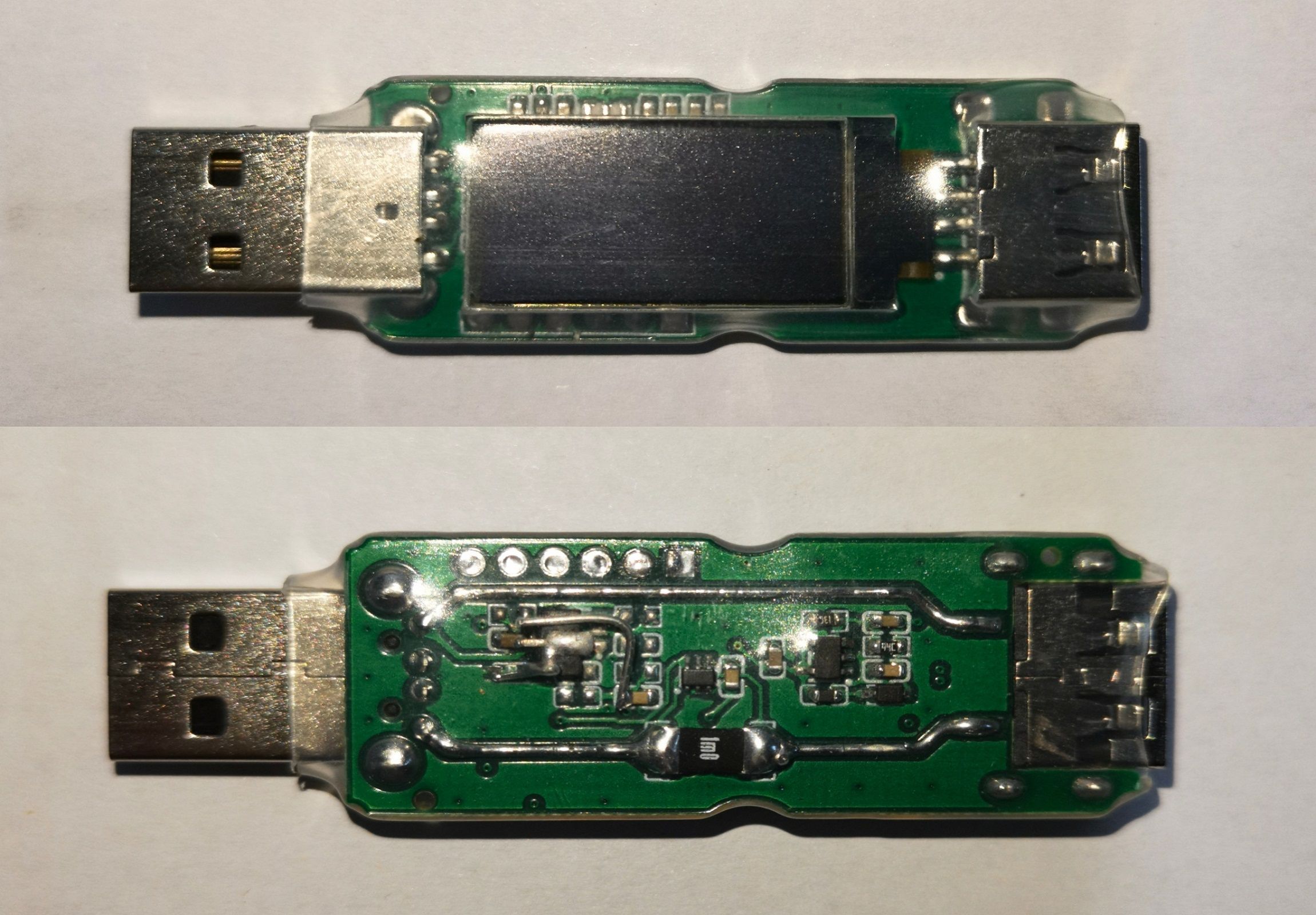

* 1. Project function introduction
N32G430C8L7+INA199 USB power meter, which can view voltage, current, power, 0.96-inch OLED display, with boot animation, and astronaut animation on the main interface
* 2. Project attributes
are disclosed for the first time, the software and hardware refer to the official case, and the OLED display part is original
* 3. Open source agreement
CC-BY-NC-SA 3.0
* 4. The hardware part
refers to the official case design, and the OLED part is different. This project uses a 0.96-inch 12864OLED bare screen and adds its peripheral circuit and boost circuit.
Because the BL9342 part does not output voltage for unknown reasons, it is forced to use a flying wire to weld an LDO to convert the input voltage to 3.3V
* 5. The software part
refers to the official case design, and the OLED display part is original, with boot animation and astronaut animation.
See the attached project.
