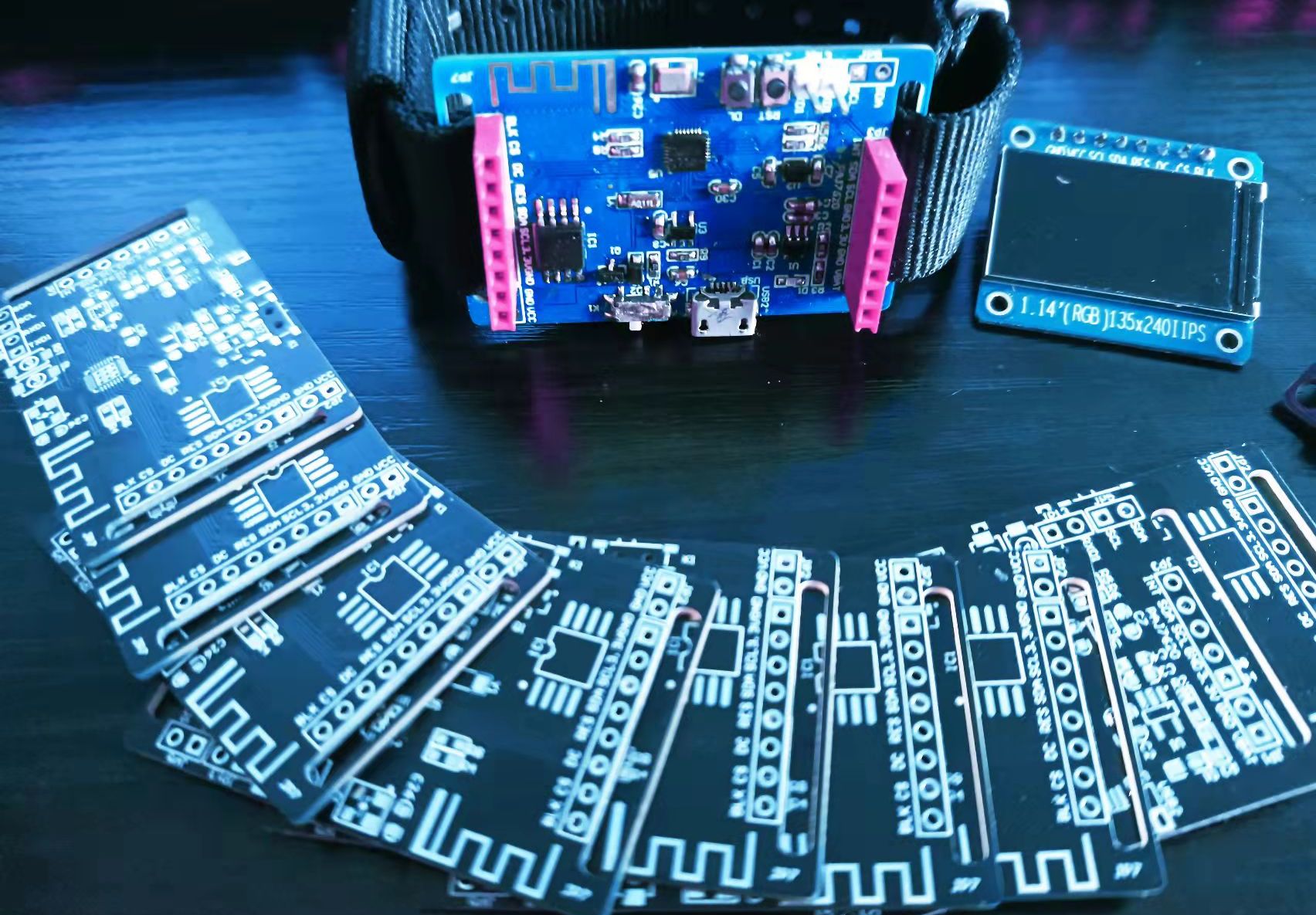

The Bluetooth master control is developed using Qinheng Microelectronics ch579F series Bluetooth BLE.
The onboard 1.14-inch SPI screen displays UI, etc.
External 8M SPI Flash stores UI, fonts and other resources.
TP4065 lithium battery charging management chip.
Three-axis gravity acceleration sensor.
Gesture sensor.
Video link:
Implementation function:
1. The astronaut dial displays the time, and Bluetooth synchronizes the time.
2. Raise your hand to brighten the screen.
3. Use air gestures to switch songs, etc.
Uploaded to git software and hardware for open source:
https://gitee.com/xiaoqixiaoqi04/ch579_ble_application.git
