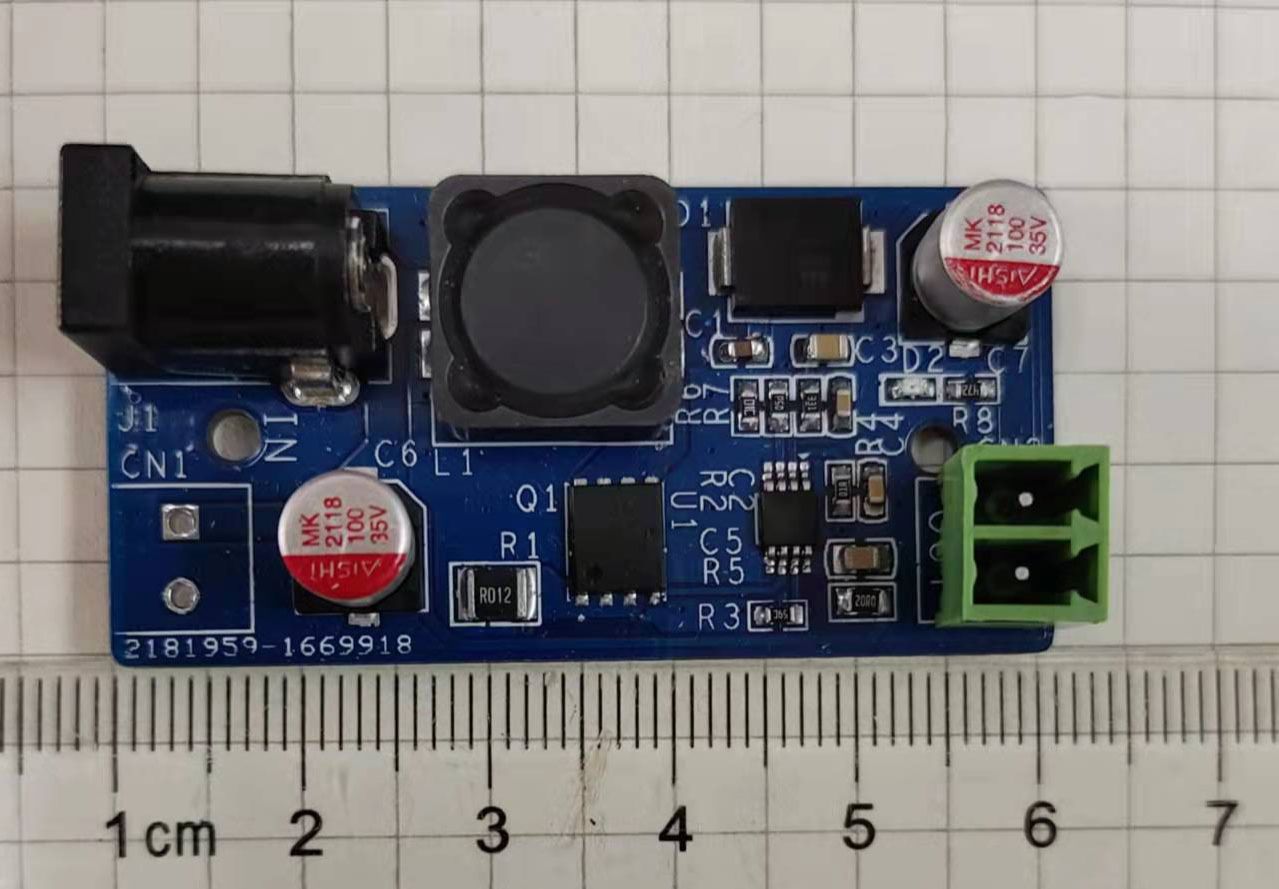

This is an automatic buck-boost module based on LM3488.
The design parameters are:
        Input voltage: 5~24V
        Output voltage: 12V
        Output current: 1A
In the actual test (output 12V@1A, input 5~24V continuous test) the highest efficiency is about 86%, and the lowest efficiency is about 75%.
If a damping resistor and a fast turn-off diode are added to the MOS tube gate, the efficiency will be improved.
The inductor uses 1260 coupled inductor;
The sampling resistor and compensation circuit parameters can be modified according to your own needs.
Figure 1 Schematic diagram
Figure 2 PCB Layout
Table 1 Bill of Materials
Item Number Value Footprint Quantity Part Reference
1 1uF/35V 0603 1 C1
2 820pF/50V 0603 1 C2
3 100nF/50V 0603 1 C3
4 100pF/50V 0603 1 C4
5 100nF/50V 0805 1 C5
6 100uF/35V Case D8 2 C6, C7
7 MKDS-1/2-3,81 3.81-2P 2 CN1, CN2
8 B560C SMC 1 D1
9 Red 0603 1 D2
10 DC-005-20A DC-005-3P 1 J1
11 15uH/4.27A 1260 1 L1
12 DMTH8028LPSW-13 PowerPAK SO-8 1 Q1
13 13mR/1% 1210 1 R1
14 100R/1% 0603 1 R2
15 46.4K/1% 0603 1 R3
16 1.24K/1% 0603 1 R4
17 20R/1% 0805 1 R5
18 10K/1% 0603 2 R6,R8
19 84.5K/1% 0603 1 R7
20 LM3488MM/NOPB VSSOP8 1 U1
