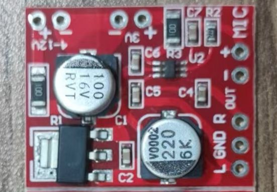

The sensor is used for sound detection. The module uses a 4-12V wide voltage input and a MAX9812 voice chip. It has left and right channel outputs and can be directly connected to the headphone holder.
Refer to the schematic diagram in the specification sheet
schematic,
A voltage regulator is added so that a wide voltage input can be applied.
PCB board diagram
There is no copper covering the entire area, considering that this board will not be mass-produced, so it is convenient for hand soldering.
It has been verified in practice that it feels average and can be used without any eye-catching design.
Welcome your criticism and guidance. Attached are the project documents.
