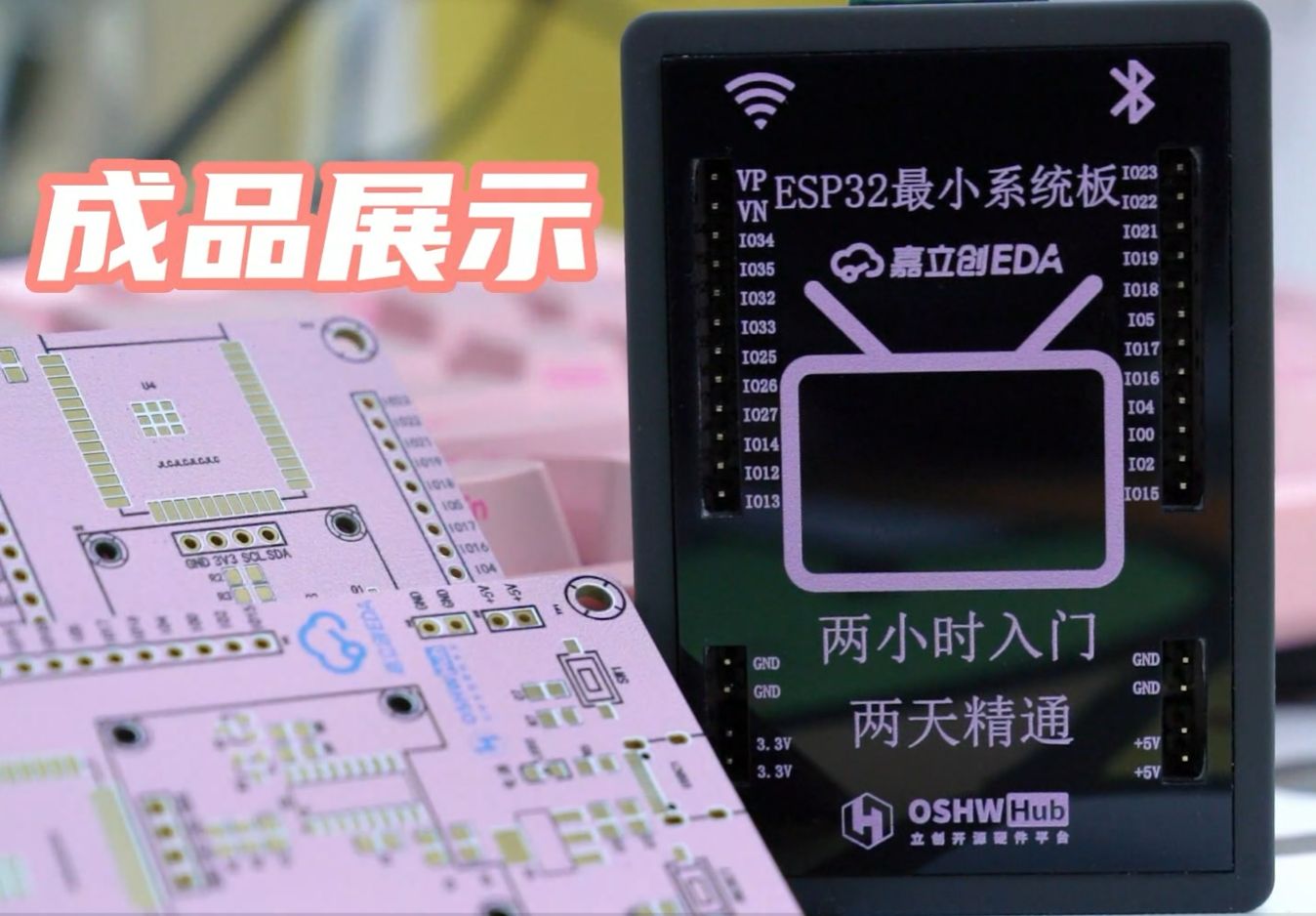

1. General Overview
      ESP32-WROOM-32E-N8 is a module designed by Espressif Systems, a domestic company. Based on this module, the minimum system board is designed, all IO pins are brought out, and OLED display, buttons and three-color light peripherals are added. C/C++/MicoPython can be used for development, which is convenient for quick entry development and learning. It is compact and exquisite with complete functions.
Figure 1-1 ESP32 minimum system board 3D model Figure
1.1 Pin distribution
Figure 1-2 ESP32 minimum system board pin distribution Figure
1.2 Onboard resources
Figure 1-3 ESP32 minimum system board onboard resources
Main control chip: ESP32-WROOM-32E-N8 Module
power interface: TYPE-C
Function buttons: Reset button and Boot button
Display function: Power indicator light display, two three-color light displays, four-wire OLED screen display
Debug interface: CH340 serial port debugging
External pins: Full-function pins are brought out for easy expansion of connections;
1.4 Advantages and features
Figure 4-1 Minimum system board size diagram
The board is small and exquisite, with a size of 50mm*74mm (1968.5mil/2913.4mil);
supports development using C/C++/MicoPython language, which is convenient for quick learning;
provides TYPE-C serial port for easy development and debugging;
onboard reset button and Boot button;
supports 2.5GWiFi and BT/BLE wireless communication;
has two three-color lights and a four-line OLED display to meet the development and learning needs of beginners;
uses Jiali Chuang's high-quality PCB and Li Chuang Mall genuine components to ensure product quality;

3.9. PCB layout It is recommended that
the main control module be placed in the middle of the board frame, and the antenna should not be placed inside the board frame to avoid interference.
It has a certain space capacity. The OLED display is connected through a female header. The screen printing on this side of the display only indicates the size and the position of the screws around it.
The expansion pins for placing components inside the screen printing are placed on both sides. Pay attention to leaving a position for the screen printing
to place screw holes around. At the same time, a prohibited copper plating area should be placed around the screw holes. Place the short-circuit
filter capacitor nearby. The power supply must first pass through the capacitor and then to the chip.
3.10. PCB wiring recommends that
the power line be set to 30mil, because the ESP32 module requires a large current. The signal line is 10mil, that is, the top layer
can used as the main routing. If it cannot be passed or needs to be routed a long way, switch to the bottom layer through the via for
connection. Straight lines are preferred during routing. Do not route at right angles or sharp angles. Route horizontally, vertically, and symmetrically to keep the design beautiful.
During the wiring process and after the routing is completed, place GND vias appropriately for heat dissipation and ensure that the return path of the current is as short as possible.
3.11. Silkscreen copper plating suggestions
Figure 3-11-1
Add silkscreen logo buttons and external pin information to the top copper plating;
add teardrop effects after drawing and adjusting the PCB to make the board more beautiful and stable;
add JLCJLCJLCJLC to specify the guest editing position under the components to make the board beautiful;

5.2. Device welding
      On the PCB editing page of Jiali Chuang EDA professional board, select tools, open the welding auxiliary tool to help quickly locate the device position.
Figure 5-2-2 Bottom welding diagram
Welding precautions
First weld TYPE-C, make sure that TYPE-C has no welding short circuit, then weld the others After
the SMD components are welded, weld the plug-in pin and mother row
Before welding the chip, use a multimeter to measure whether there is a short circuit, place the burnt chip
5.3. Finished product display
Figure 5-3-2 Actual Figure 2
