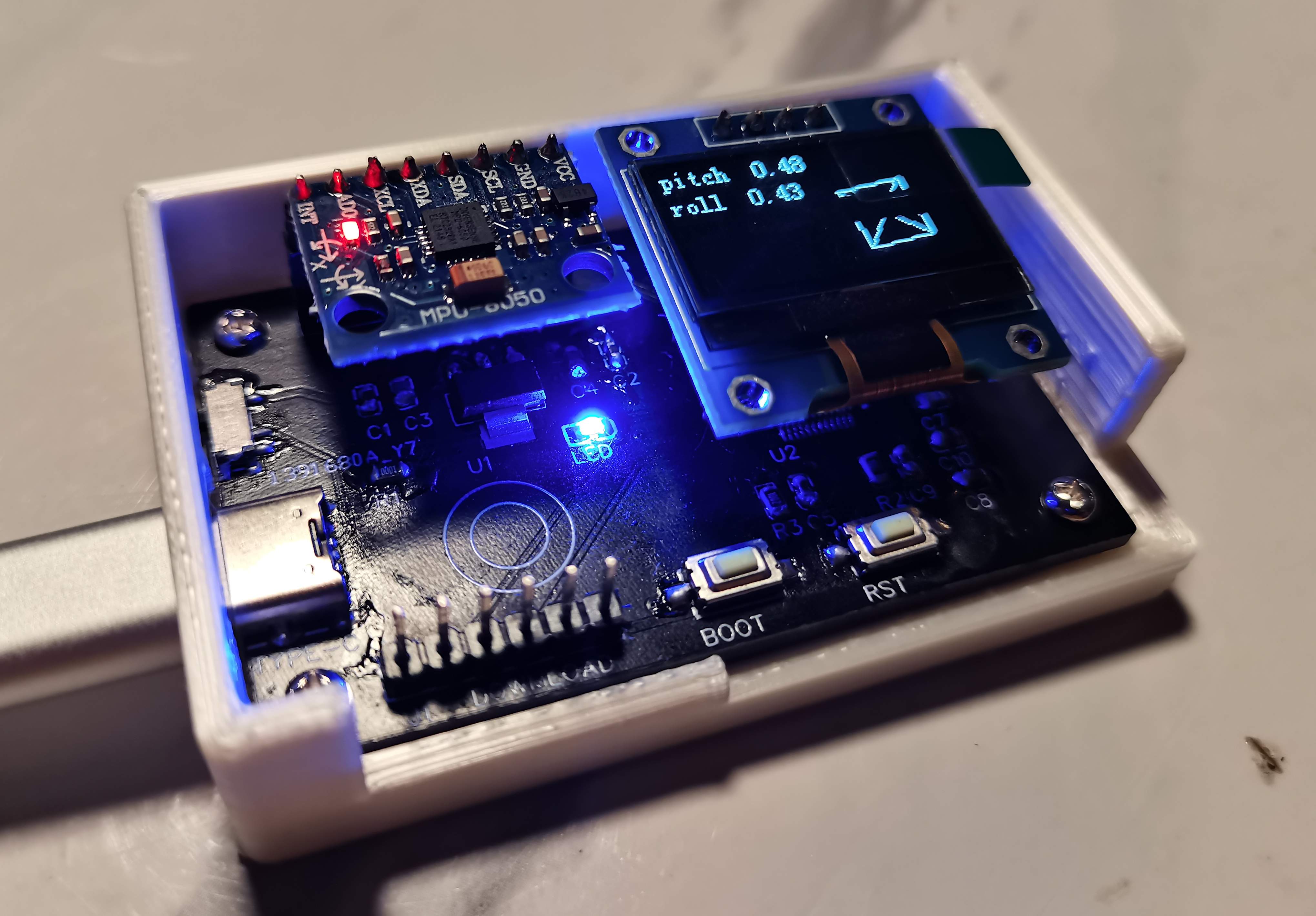

       This design is based on the N32 microcontroller design project - a real-time attitude meter based on N32G430, which can collect attitude data from MPU6050 and then display it in real time on 0.96 OLED.
       The design architecture of this project is shown in the figure. It is mainly composed of the main controller N32G430C8L7, MPU6050 sensor, OLED display module and other parts. It can collect the original acceleration and gyroscope acceleration through the MPU6050 sensor. After receiving the data, N32G430 converts it into the attitude of the module and displays it using OLED.

       The hardware structure is shown in the schematic diagram. It is mainly composed of the main controller N32G430C8L7, the six-axis sensor MPU6050, and the display module 0.96OLED.

         This project uses 0.96-inch 4-pin OLED, driven by SSD1315. The OLED screen used in this project uses the IIC interface.
         IIC interface: GND: power ground VCC: 2.2V~5.5V SCL: CLK clock (high level 2.2V~5.5V) SDA: MOSI data (high level 2.2V~5.5V)

*5. Shell structure
       Considering the protection of the circuit and the aesthetics, I used SolidWorks to draw a base and tested it. The STL file will be shared in the project attachment.
Note: I used M2×6 screws.
