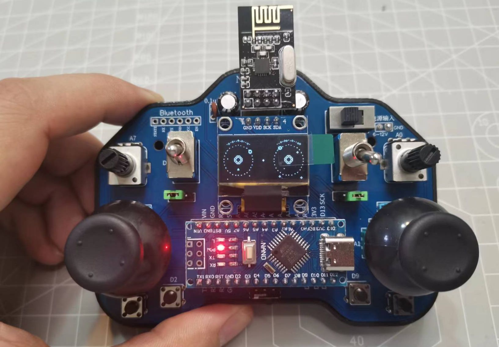

Yufeng nano/mini micro remote control (Arduino nano/promini main control + mpu6050 + nrf24L01 + OLED), two high-precision joysticks, PCB size 10*7.5CM, can be used to do various interesting projects. It supports two modes: normal and debugging. In the debugging mode, the joystick can be fine-tuned to the center position and the control reverse direction (the open source version of the program currently does not have screen display content and debugging mode).

There are two types of NRF24L01 modules painted on the Nano version PCB. One is the patch type, which I used for testing. You can choose one of the pin type. When making, pay attention to soldering the Mpu6050 module last (only solder the solder pins on the PCB first), because the battery box is fixed with a screw under the 6050. Install the battery box first and then solder the 6050 after the power-on test is normal.
The information package contains some reference open source materials, including a sample file of the receiving board of the Arduino Promini master control, as well as a reference program, on which you can freely play.
