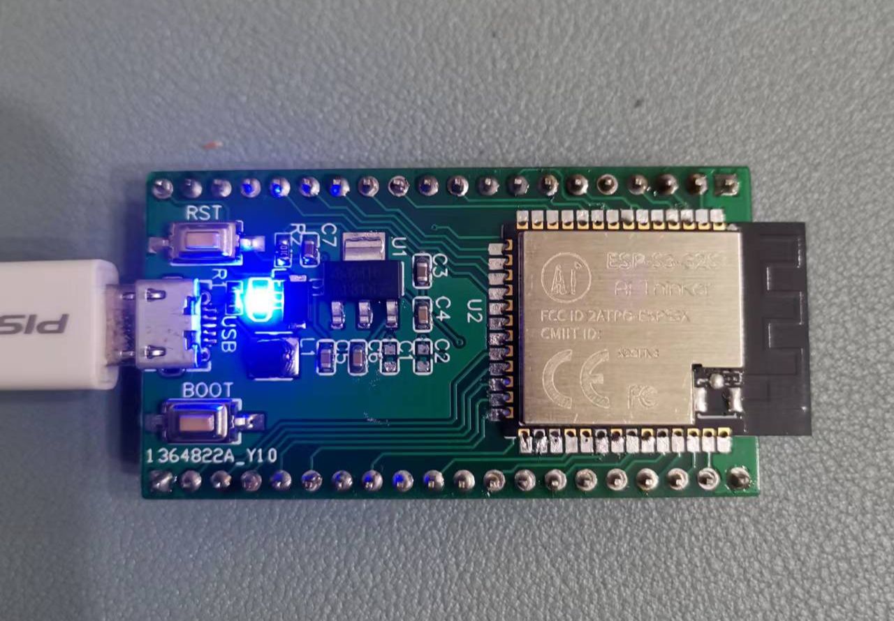

The ESP32-S3-32S module has 38 pins.
In addition to GPIO19 and GPIO20, these two pins are used to interconnect with USBD-/USBD+.
It should be noted that when using this development version to develop, do not use the two ports GPIO19 and GPIO20. Forcible use will cause the firmware to fail to be flashed through USB. You can only use the TTL method to flash in, which is very troublesome.
The components used are all widely used and cheap ones selected from Jialichuang's mall. The only unfriendly thing is that the resistors and capacitors are of 0603 specification, which is not friendly to rivals.
