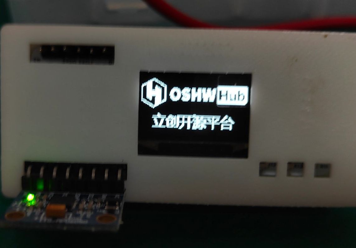

Power meter based on N32G430C8L7 + MPU6050 attitude detection

*4. Hardware Current
sampling: INA199A1DCKR is used to monitor the load current. The gain of this model is 50, and the full scale is 66mv under 3.3V reference. Using a 10mΩ sampling resistor, it can detect approximately 6.6A current. The selected sampling resistor power is 3w, and the maximum current can be around 17A.
yF2mrkXj7zcVsFhFucX8otw51pPw9NtNNyJVfjjs.pngVoltage sampling: Voltage sampling uses resistor voltage division, with a pressure ratio of 91:10, and can measure approximately 30V voltage under 3.3V reference. Chip power
Y9Vltm5WUtEk8Xf0Zt12hDUOPFEI2BAqgyW2pXwN.pngsupply: The power supply uses 1117-3.3 with a maximum input of 18V and an output of 3.3v to provide 3.3 power supply to the chip and on-board devices;
Each power supply port of the MCU chip needs to add a 100nf capacitor, and pin 1 needs an additional 4.7uf capacitor.
XV88hDdxGcdwqPwHfWP7nMl5GFx2b1tNcbNn1KfQ.pngDisplay screen and MPU6050: The display screen and MPU6050 communicate with the MCU through the IIC interface, and PB8, PB9 (I2C1) and PB10, PB11 (I2C2) are brought out as communication ports.
0.96OLED (SSD1603) display screen module and GY521 (MPU6050) module are used for
fast charging: The board that was first installed was not connected to D+ and D-, and could only provide 5V. After the 0.5A output,
the D+D- is connected by flying wires on the board. As in the current circuit connection, the 9V2A PD fast charge can be achieved using an ordinary fast charging cable.
However, when using the super fast charging of a mobile phone (OnePlus 9RT), the device will restart when the current reaches about 4A, and the load has no output. It may be because the CC line and VCONN are not connected, causing the protocol to shut down the output. In
addition, I found that the U port end of my data cable seems to have only 5 pins. The cable U port found on the Internet has 6 wires. How can it be connected with the 6 wires on the C port end? .
