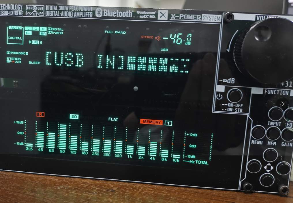

  • In June, I accidentally got some old audio equipment and found that the screen used VFD. The display effect was very good, but it was too bulky and generated serious heat. It was very inconvenient to use and could not be used in a small space. So the idea came up to miniaturize these devices.
  • The power amplifier uses a high-efficiency Class D amplifier, model TPA3251 from Texas Instruments, which uses PurePath technology to allow efficiency and low distortion to coexist.
  • The spectrum and EQ adopt a hardware solution. I originally wanted to use FFT to do the spectrum. However, since I am a hardware engineer and not very familiar with software algorithms, the production was extremely laggy and gave me a headache, so I could only use BPF+MUX. plan.

  • X-POWER Series 03P-DIXT-1300-EXTREME has multiple audio source selection, lossless Bluetooth decoding, USB decoding, EQ, digital volume adjustment, and spectrum display functions.
  • The onboard 360W peak power boost power supply has a wider input range (12-24v), so you can use a cheap server power supply as the power input.
  • The input has an anti-reverse connection function, which effectively prevents the power supply from burning after reverse connection.
  • The onboard delayed start circuit effectively avoids sparking when powering on.
  • Audio source input: RCA TRS (3.5MM) USB BLE.
  • Volume adjustment: DIGITAL.
  • EQ function: YES
  • Spectrum display: 14 frequency points, 15 segments of resolution.
  • Input overload protection: YES.
  • Output short circuit protection: YES.
  • Output overcurrent protection: YES.
  • Clip warning: YES
  • Display mode: VFD
  • Save after power off: YES

Display panel (no acrylic panel installed)
