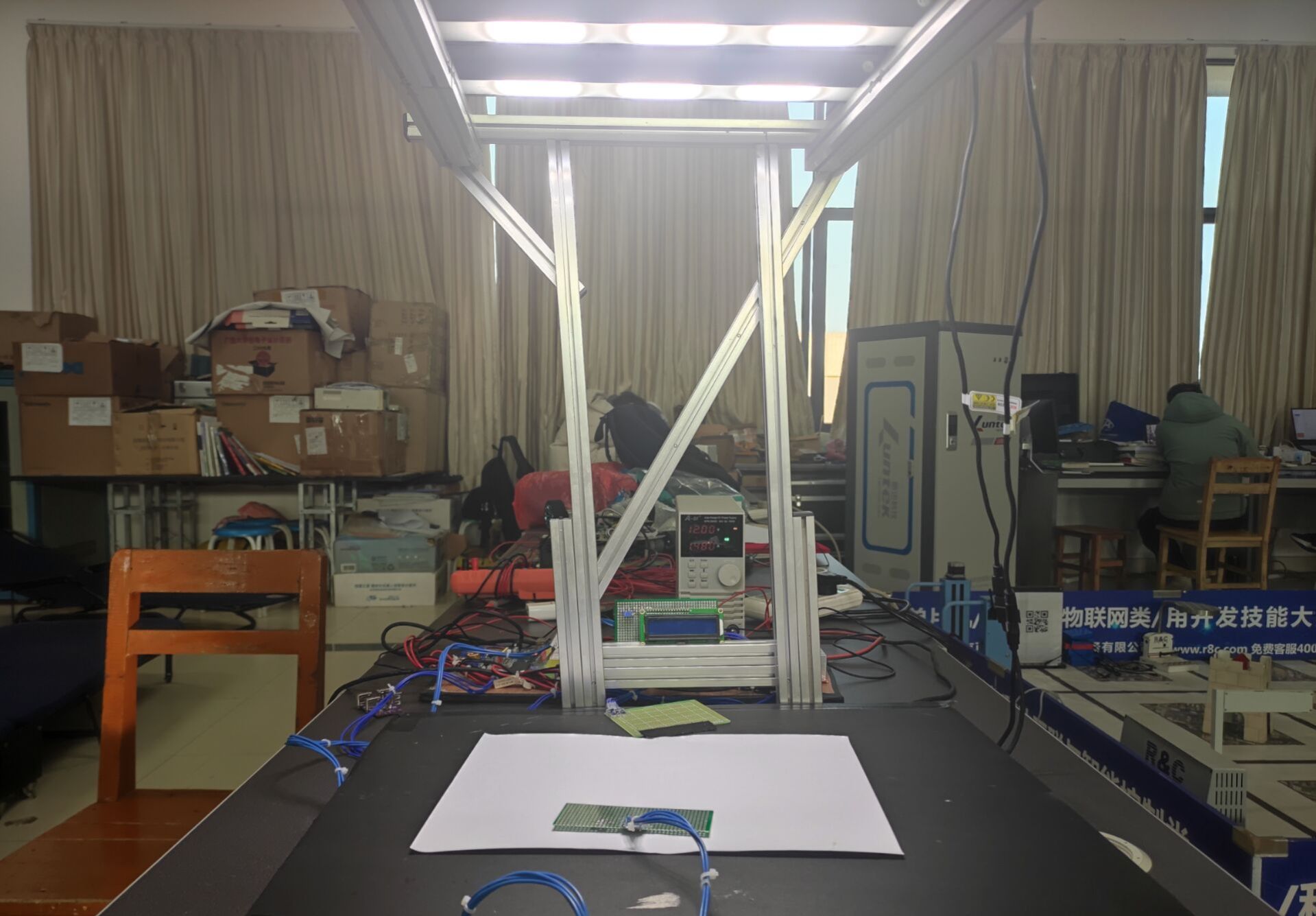

7. Physical display
This product can achieve continuous brightness adjustment and automatic adjustment, but the power consumption can only be maintained at about 85%. The best performance depends on the placement of the desk lamp.
8. Work assembly
