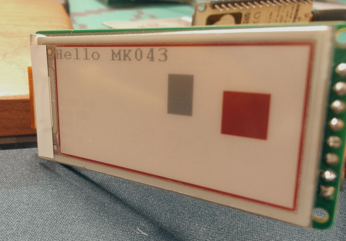

illustrate
The measured three-color 2.13-inch display can be displayed perfectly when used normally.
Connection pins:
BUSY D2
RST D4
DC D3
CS D8
CLK D5
DIN D7
Development tools: PlatformIO, Arduino IDE
Download rate: 921600
The test code attachment is shown below, using NodeMCU
If you update ESP32, use a homemade board
