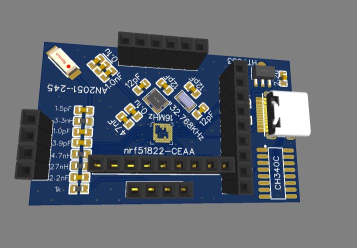

I bought a lot of brand new CEAA with ribbons for two yuan a piece . I drew a fully functional test board (about 5*3cm) with all the pins out.
The size of CEAA is very small, about 3mm*3mm, which is a quarter of the area of common QFAA . Several vias have to be drilled on the pads. If there is poor contact, please cover it with green oil.
