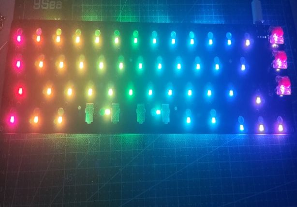

* This PCB has been verified
* Updated source code and firmware, fixed the problem that the WS2812RGB coding order is inconsistent with the datasheet provided by the merchant
* Added some lighting and function demonstration videos

* With RGB axis light bottom light (WS2812), it can realize analog bottom light axis light control (QMK support or OpenRGB). Onboard 80 lighting effects, support OpenRGB music rhythm, etc., rich playability, see [OpenRGB open source community](https://gitlab.com/CalcProgrammer1/OpenRGB) for details.

## PCB
![pc.png]
![pcb2.jpg]
![pcb3.jpg]
