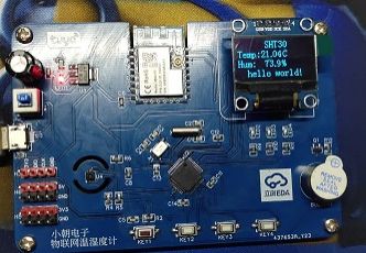

Temperature and humidity sensor based on Tuya Smart
IoT thermometer and hygrometer based on Tuya and Lichuang EDA. The main function is to allow users to check the temperature and humidity of the environment where the device is located anytime and anywhere. 1. The wifi module is Tuya's WBR3 2. The MCU is GD32f103c8t6 microcontroller, 3. USB 5V power supply, 1117 3.3V step-down chip 4. 0.96-inch OLED display 5. 3 LED status indicators 6. 3 button inputs eliminate the need for configuration Internet, the process of self-development greatly shortens the development cycle. Since this is the first time I have made it, simple peripherals have been added to make it easy to learn and can be used as a development board. Unfortunately, the network distribution part of the module has not been completed. The board only collected the temperature and humidity, but failed to upload it to the cloud and the mobile phone.
