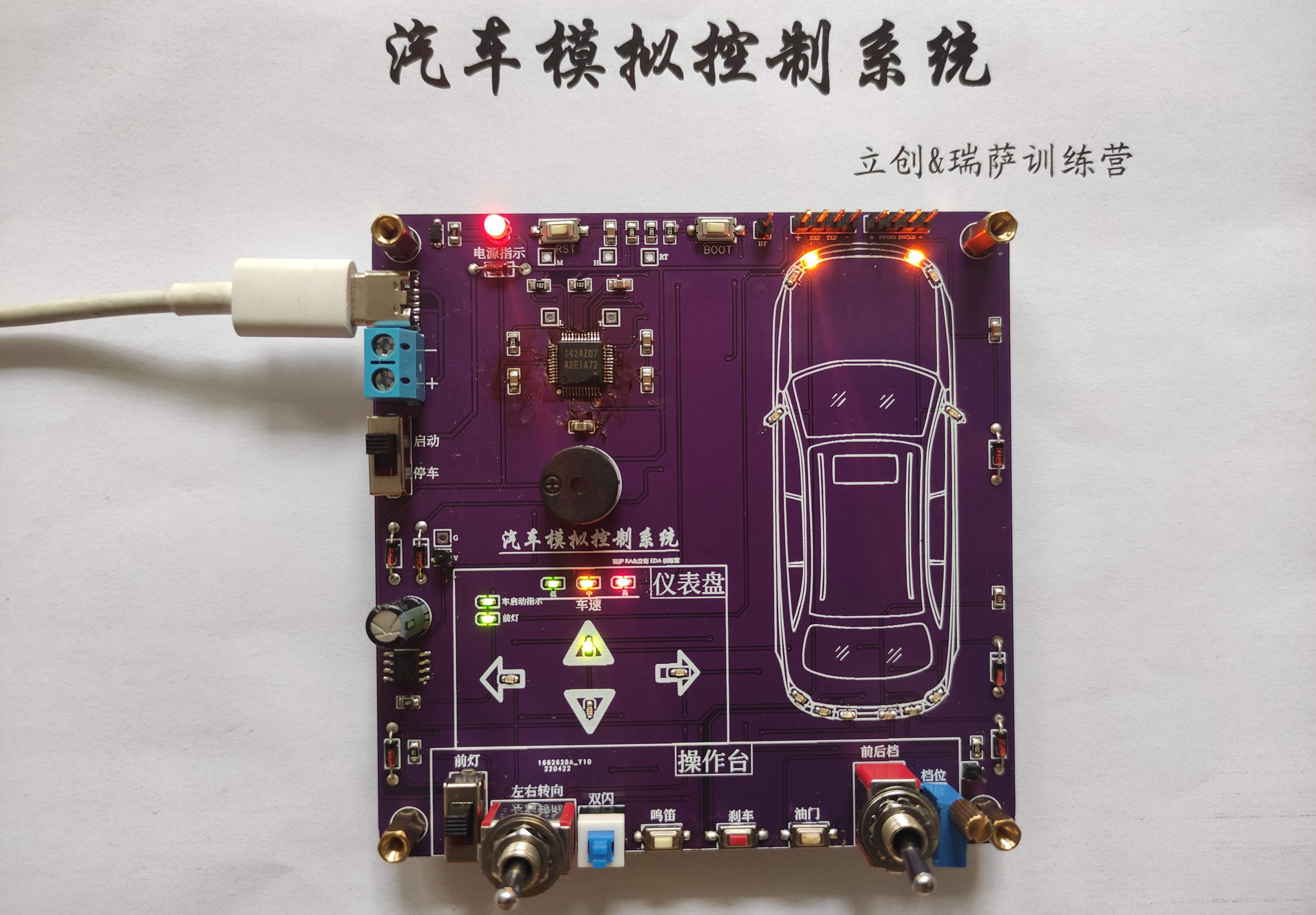

1.1 Function Overview
  This project uses Renesas MCU as the main control to create a car simulation control system. Through the logic design of the circuit, it simulates car startup, front and rear gears, speed gears, throttle, Braking, speed light indication and screen display, speed warning, left and right steering, headlights, reversing lights, brake lights, whistle, emergency double flash and other functions.
1.2 Actual picture

2.2 Schematic description
  The circuit schematic is shown in Figure 2.2, drawn according to the functional modules, including power module, main control module, debugging interface, accelerator and brake module, forward Reversing module, speed display module, whistle circuit, turn signal and emergency double flash module, reset circuit, reserved test interface, etc.
2.3 PCB design
  PCB design is shown in Figure 2.3.
  (a) (b) (c)
Figure 2.3 "Automobile Simulation Control System" PCB design drawing
(a) Wiring diagram (b) 2D diagram (c) 3D diagram
  The functional distribution of the PCB is mainly divided into four parts, namely the operating console , instrument panel, car display, and other components, as shown in Figure 2.4.
Figure 2.4 "Automotive Simulation Control System" PCB Function Distribution Figure
2.4 Software Description
   The main control chip is Renesas R7FA2E1A72DFL. The main control program is written using e2 studio. It mainly uses I2C external OLED screen, ADC analog signal acquisition and GPIO functions. The pin definition is shown in Figure 2.5.
Figure 2.5 Renesas R7FA2E1A72DFL pin diagram
