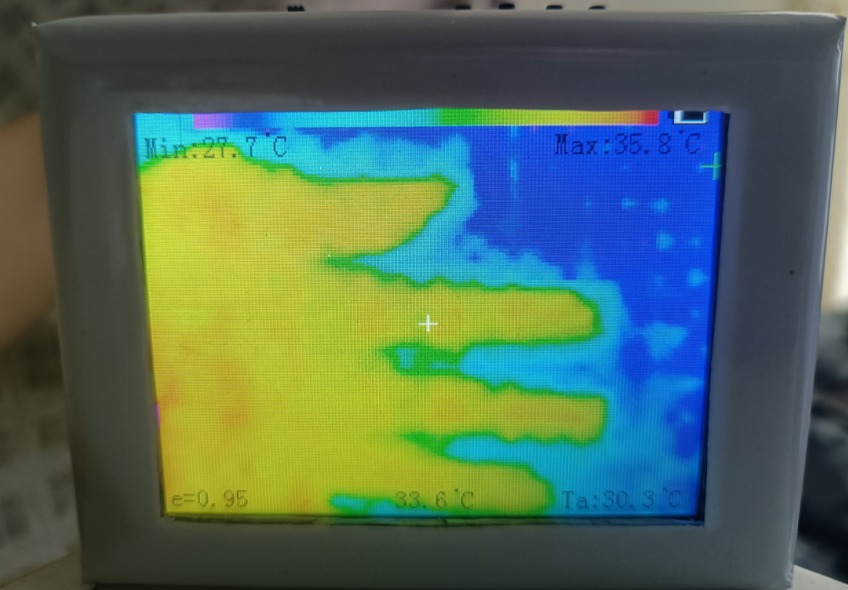

Therefore, I need an infrared thermal imaging camera, but I looked online and it costs around 2,000. Although the resolution is very high, I don’t need such good performance, so I just made one myself. The infrared pixels of the AMG8833 are 8x8, which felt too low, so I chose the MLX90640 with 32x24 pixels. The price on Taobao is 172 yuan. Together with the microcontroller and LCD screen, it can be done within 300 yuan.
What it looks like when finished:
Has the following functions:
1. Powered by lithium battery and charged by USB port.
2. Built-in 16M SPI flash, the size of an infrared picture is 150K, so 109 pictures can be saved.
3. SPI Flash is used as a virtual U disk. You can directly view and copy the saved pictures by connecting it to the computer through the USB port.
