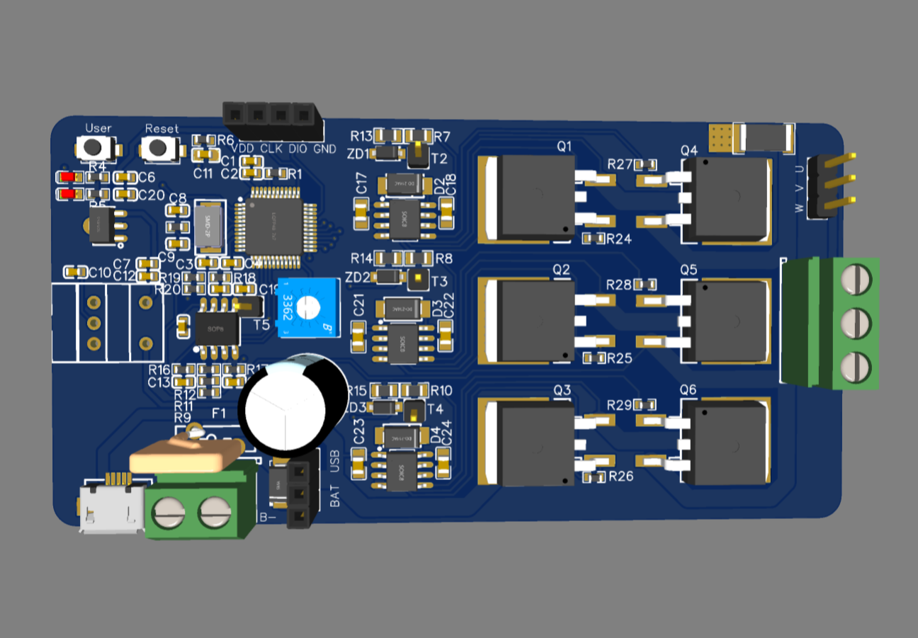

Use CW32F030 as the main control brushless motor driver board to learn how to drive brushless motors.
It should be noted that the input voltage range of the board is 10~12V (in order to simplify the circuit, AMS1117 is directly used to generate the 3.3v voltage of the digital part. If the voltage is too high, the LDO will be damaged, and if the voltage is too low, the gate driver chip will not work). You can add DC-DC Step down to generate the digital section voltage to support higher input voltages.
