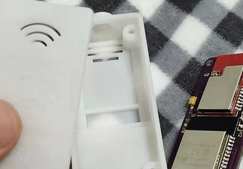

Proofing has been completed and tested on the machine. Please feel free to eat. Comes with other materials for the 3D model
: Screws: https://item.taobao.com/item.htm?spm=a1z09.2.0.0.42392e8dq1V9PU&id=522574685586&_u=31qjevsr0d65 Female header: https://item.taobao.com/item.htm ?spm=a1z09.2.0.0.42392e8dq1V9PU&id=553878760279&_u=31qjevsre6c0
opentx/edgetx script installation:
    1. Script address: https://github.com/ExpressLRS/ExpressLRS/blob/master/src/lua/elrsV2.lua 2. Use Method: Copy the downloaded script to the /SCRIPTS/TOOLS directory of the SD card. If there is no directory, create it in sequence and then copy and flash
the firmware:
1. Firmware download tool: https://github.com/ExpressLRS/ExpressLRS -Configurator/releases2. Preliminary preparation: usb ttl tx - rx, rx - tx. Press the boot button on the board to power on. 3. Download process: Select DIY 2.4G E28 and click download. Subsequent OTA upgrades can be performed directly via WiFi.
