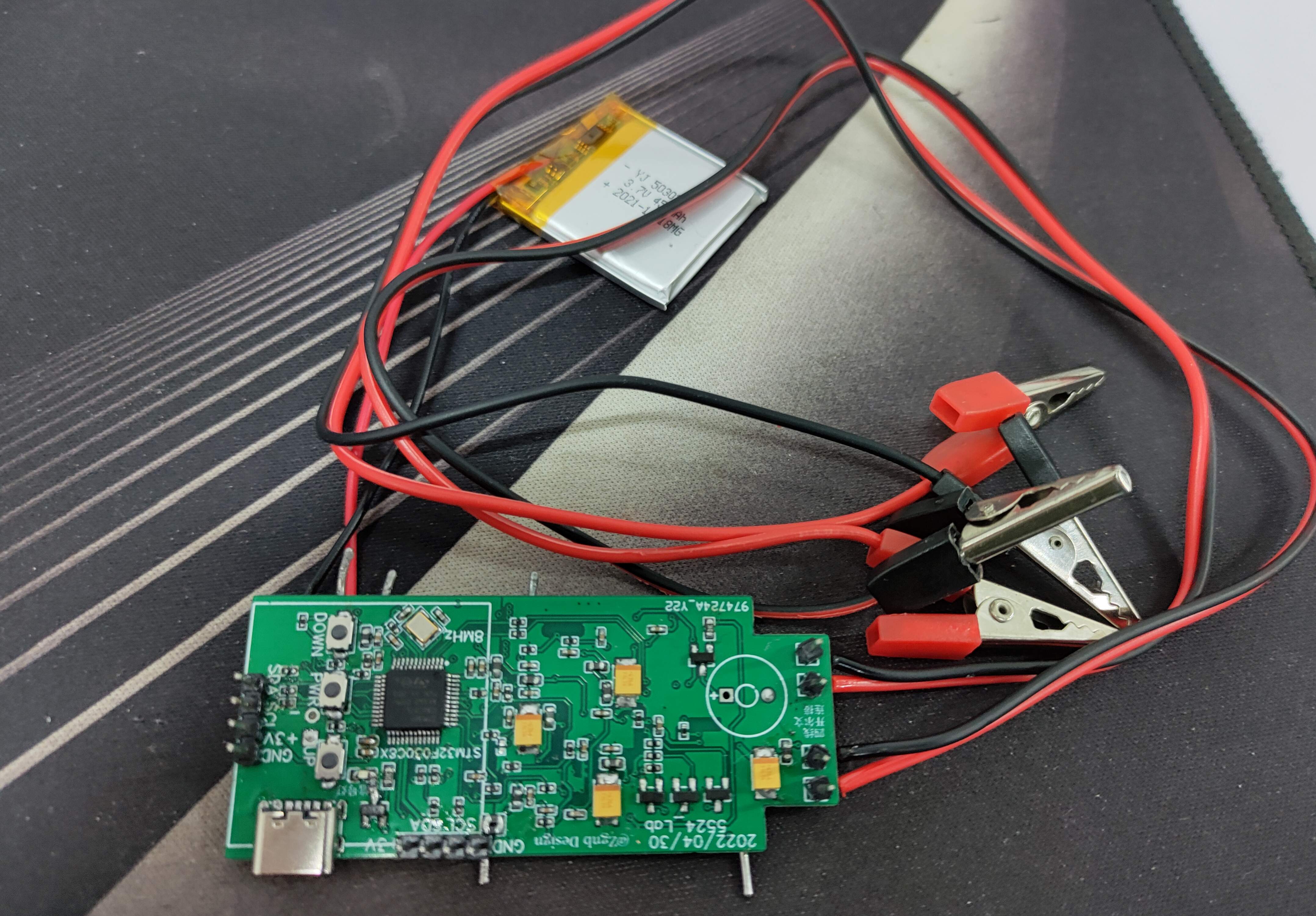

Schematic design
The schematic is the latest schematic. I made a version and found that the power supply of 8554 was connected reversely. This wrong schematic has been fixed. The PCB in the
PCB design project is the first version of the PCB. The power supply of 8554 is reversed and cannot be used directly! When debugging the work, I cut off the wire of the power supply pin of the 8554 chip, jumped two wires, and the circuit became normal. There is a waveform output at the output end. The actual work and the debugging results. The front view and the back view clip a 47k resistor. You can see the oscilloscope waveform, as shown in the figure: Resistor voltage drop Vpp1: 1.12V Resistor current Vpp2: 2.36V voltage effective value calculation: U= Vpp1/magnification/ (2*0.707) = 0.19796V Current effective value calculation: I= Vpp2/amplification factor/(2*0.707)/transimpedance amplifier resistance 100kΩ=0.00000041713 Resistance value calculation: R= U/I = 47457Ω Measurement result analysis: multimeter The measured resistance value was 46.3KΩ, and the measuring instrument measured the resistance value 47.4KΩ, with an error of 2.5%. Program introduction None. I am not good at academics, so I need to hire external help to write the code, but the code has not been written yet. This is the summary of this version. Other functional debugging will be tested in the next version. Bye-Bye.
