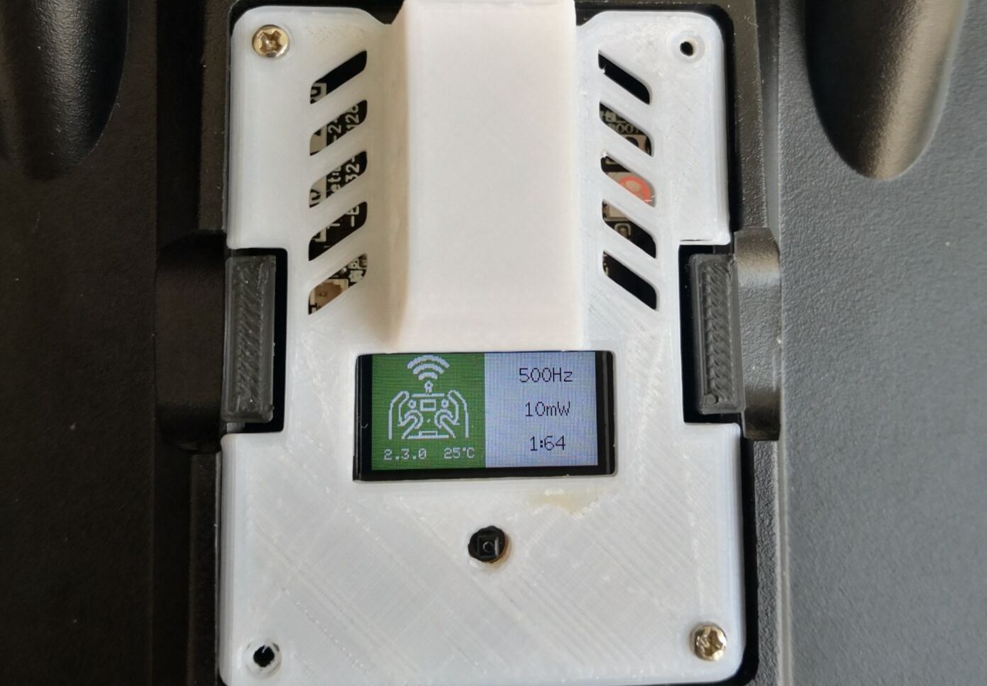

V3 version IPS color screen + button + backpack + fan fully integrated
2022.03.18
See the attachment for full set of information download
Features:
Modular assembly E28, ESP32, DCDC voltage regulation, single-sided integration.
Cool color screen, 5-dimensional button, backpack function, cooling fan, RGB light.
Simple shell is easy to print, and the screen button fan is fixed on the transmitting motherboard.
IMG_257
1. ESP32 module, ESP32-WROOM UE without antenna is recommended, or ESP32 U and other 32 modules with the same interface are all OK. If you use a pcb antenna, you need to cut it off.
2. Ebyte e28 2g4m27s RF module, lora modulation signal, SX1280 chip. You need to replace the resistor to use an external antenna and cut the pcb antenna.
3. The extended display board is plugged into the transmitter board through a 1.27mm female row to reduce the complexity of the shell.
4. 0.96-inch TFT color display with a resolution of 160x80, supports plugging in bare screen 8P and welding bare screen 13P.
5. The 5-way button controls the screen, and the high-frequency head can be externally powered by USB, which is convenient for non-open source remote control.
6. The launch board and expansion board are basically single-sided layout, which is convenient for welding with a ten-dollar "LED desoldering station" to reduce the difficulty of production.
7. The cooling fan can be fixed on the launch board and not higher than the bottom box space to reduce the complexity of the shell.
8. JR socket B2541BW is not easy to buy. You can consider buying 2.54 offset pin female headers (5p, the extra ones can be cut), which have been designed with corresponding pads. When buying female headers, pay attention to the plastic height not exceeding 7.1mm, otherwise the contact will be poor.
9. Thanks to AXIS for promoting color screens. The boot interface temporarily uses his pictures.
10. The 5-dimensional buttons use voltage divider resistors 5K, 5K, 10K, and 20K (5K can be equivalent to 2 10K stacked high). According to the schematic diagram, the values ​​obtained by voltage division are 1/3, 1/2, 2/3, 4/5, 0, and 1. According to the pin sequence 16342- and *4096, the values ​​of 'up, down, left, right, and middle' are 1365, 3276, 2048, 2730, 0, and 4095.
11. The simple shell is easy to print.
12. The external interface 1.25 socket can be connected to an external 5-24v power supply, and the external input Sport remote control signal can be used to lead to the tx rx flash port. (Newly added in v3.2 version)

For a TFT screen using a plug-in cable, the thickness of the two PCB boards should be 1.6mm;
JR bottom box inner height 17-stud 4.5, available height 12.5; - Button height 2mm (1.5mm including the screen) - Upper PCB board, i.e. expansion board 1.6mm - 1.27 pin row plastic 1.7mm - 1.27 row mother plastic height 4.6mm - Bottom pcb launch board 1.6mm = 1mm Reserve the gap between the screen and the upper cover of the box.
If a soldered TFT screen 13p is used, because the cable occupies the space at the bottom of the screen, it is recommended that the PCB thickness is 1.2mm and the 1.27 row mother plastic height is 4.3mm. To use the joystick function, you need to modify the following files src/include/target/DIY_2400_TX_ESP32_SX1280_E28.h
based on the official one 1. Add the enable button function at the beginning #define HAS_FIVE_WAY_BUTTON 2. Define the ESP32 GPIO pin used by the joystick button #define GPIO_PIN_JOYSTICK 35 3. Set the voltage divider value for each direction of the five-way joystick // The V3 version of the TFT expansion display board has five-dimensional buttons (5k5k10k20k voltage divider) using this / Joystick values ​​{UP, DOWN, LEFT, RIGHT, ENTER, IDLE}*/ #define JOY_ADC_VALUES {1365, 3276, 2048, 2730, 0, 4095} Voltage divider value calculation method: The joystick is connected to 3.3V through a 10K resistor to obtain a reference voltage. Measure the joystick - GND voltage reading V when pressing different direction buttons, V / 3.3 x 4096 = values.
