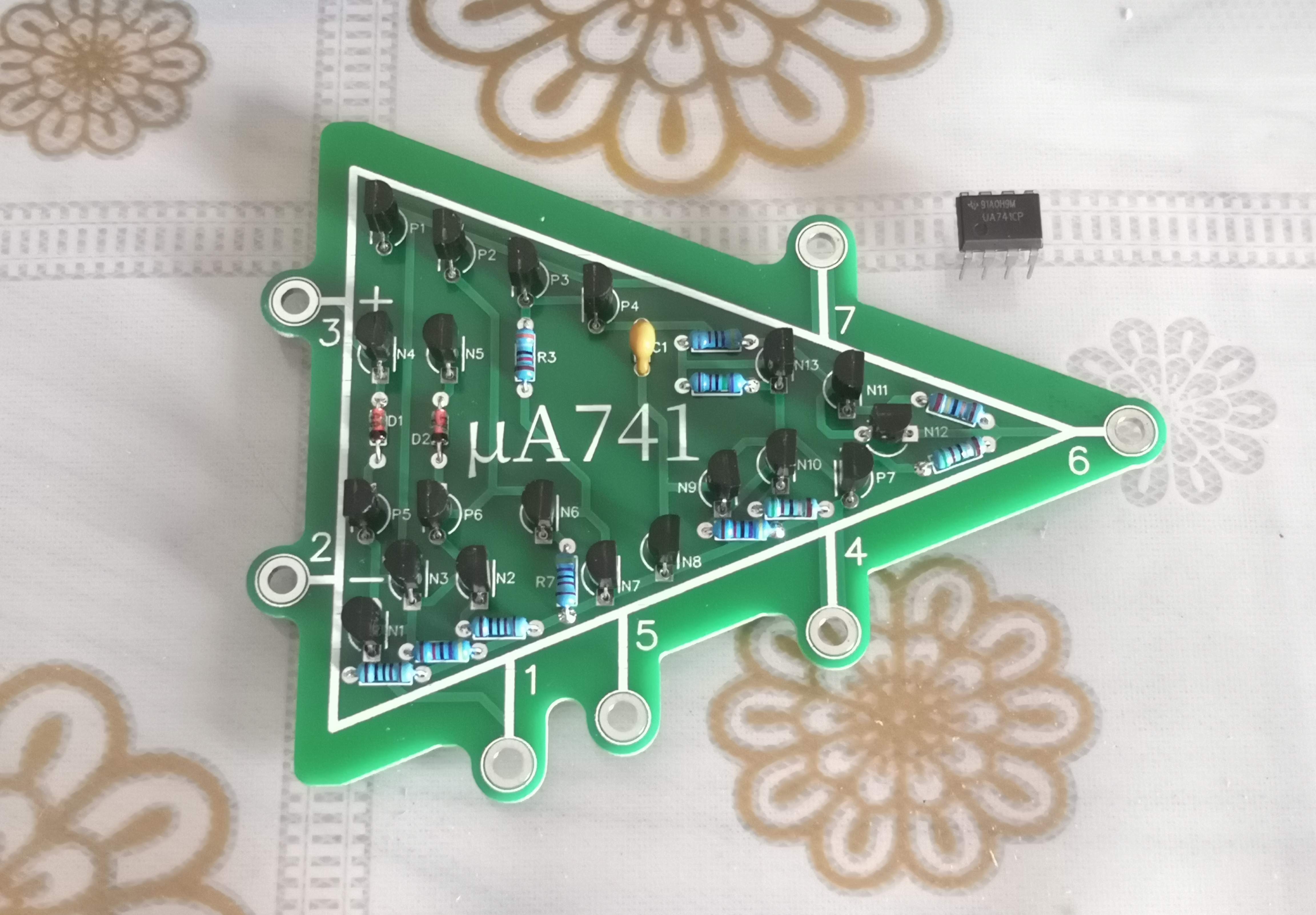

The uA741 operational amplifier is built with all discrete components. The circuit uses a circuit of the original domestic LM741. The pins are led out using F3 solder tabs. Please refer to the manual for various parameters.
The unconnected pin 8 is omitted and can be used for external zero adjustment.
Demo video: https://www.bilibili.com/video/BV11q4y1U7Da
Note: The triangular version of 741 does not have a schematic diagram and BOM, so the parameters of the resistor, capacitor, and diode are in the compressed package. All N tubes are 2N3904, and all P tubes are 2N3906.
